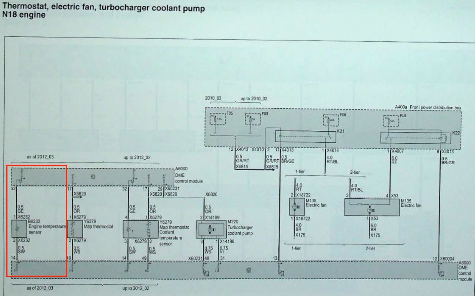

Old May 4, 2024 | 05:46 AM
Maybe, maybe not's Avatar
Maybe, maybe not
Community Builder
Community Influencer
Joined: Jul 2023
Posts: 1,506
Likes: 209
Originally Posted by scott718
Had the car scanned, indicated a "Engine coolant sensor short to ground".
This^ points to an electrical problem.
Testing the sensor wires with a multimeter might reveal the problem. [GE = yellow wire, SW = black wire]
