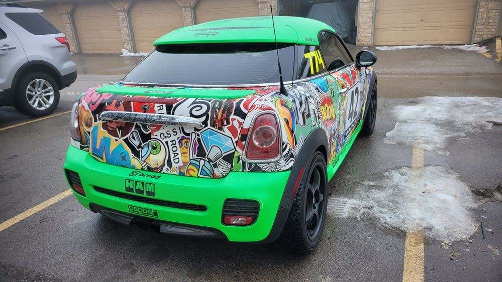

So I have an error warning light and my drivers side backup light ( one in the bumper , Unionjack flag) and it doesn't illuminate. I put a new light in ect , inspected the wiring but nothing..if worse comes to worse I will jump it off the other side light BUT I'd rather fix it correctly.
what fuse # is it because I don't see anything labeled on the back of the fuse lid in the footwell and Google lists the horn fuse as the rear backup lights ( of course )..
so where should I begin looking ?? I know the socket is fine too because I swapped it over to the other side..

I can’t help with the troubleshooting, but if the other side is working, it wouldn’t be a fuse.
Does your car have the rear fog light option?

I just went back to your build thread… Doesn’t look like you have rear fog light switch in the dashboard. However, you do have an LCI model, which came with the rear fog light trim.
Your car only has one rear reverse light - the one on the passenger side. The drivers side is the place holder for the rear fog light.
In order to get a driver’s side reverse light, you will have to jumper the housing to the passenger side. Otherwise, just get used to it.

Is that why the 2x rear lights didn't match ? Because only the passenger was the backup light ?
Maybe then I just wires these rear foglights to my brake lights so they illuminate and have a function. Otherwise the rear left one never will even light up...
I'm kinda confused , so should my car have come with the rear foglight switch panel? Because this is the cars oem rear bumper.. and I DO have a light warning on when i 1st start the car but inpa didn't say anything related to it ( though I can check again ) BUT I have NO out lights other than that drivers side bumper/fog light not working.. the lights wouldn't come mismatched like that from factory , would they ???

That is how the LCI cars were supplied. The lights were supplied in one configuration, but the rear fog light switch and activation was a factory option on the build sheet. My R55 Clubman is also asymmetrical. I am ALWAYS being told I have a reverse light out on the drivers side.

You don't need to by the whole switch panel .......the rear fog light toggle can be purchased separately .....
The car has to be coded for the rear Foglight's......The right side is the only light that works as the reverse....

Yep one side is back up and one side is rear fog on the LCI with JCW bumper kit. That has to be coded and toggle present.
Is you want to change it to duals.
