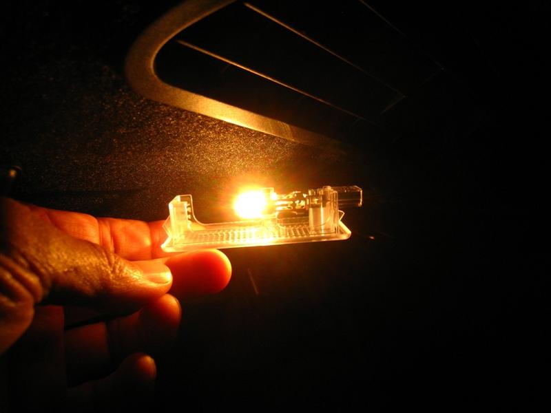

On my 2013 Clubman I had to remove the trunk lining and pop the light out from the back. I dont think there is an easy way to remove the light from the front. The grill is glued to the liner, so dont try to pry the grill off.

Here is what the trunk light looks like when it is out. If you cant pop it out from behind, you'll have to somehow pry the side. Notice that there are plastic prongs on both sides and that this is not a spring loaded light.

Thank you so much for your help. I do not want to remove the lining -__- oh well. I'll do it I guess.

You are welcome. Well here's a thought: Maybe you could somehow loop a piece of stiff wire through the vent around the back of the light fixture. If you pull towards you, you might be able to pop the fixture out.
Second optoin is to try to pry it out, but since the fixture is recessed, it wont be easy and you might break some of the plastic. yeah, this light is a pain to remove Good luck
