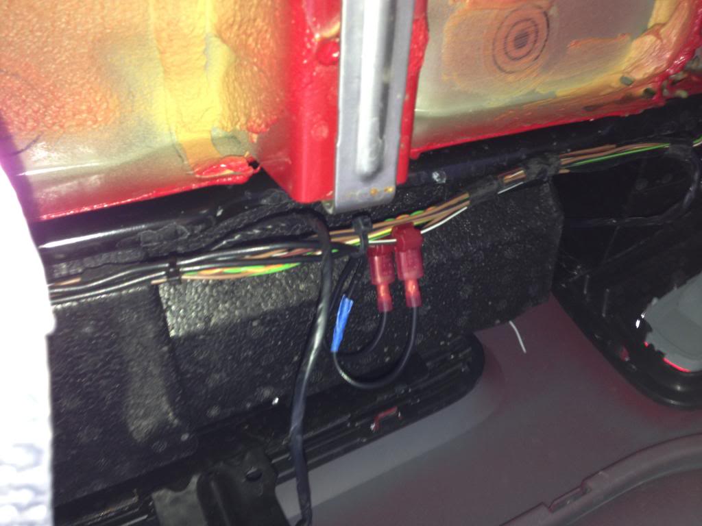

I found some black wire in my electrical box and I already had a bunch of T-tap connectors. I color coded my black wire with a piece of painters tape...LOL very professional!
Started with only one backup light working and no working fog that I replaced with a second back light on the driver' side...
A little splice with t t-tap into the working side and my awesome painters tape color coded black wire...

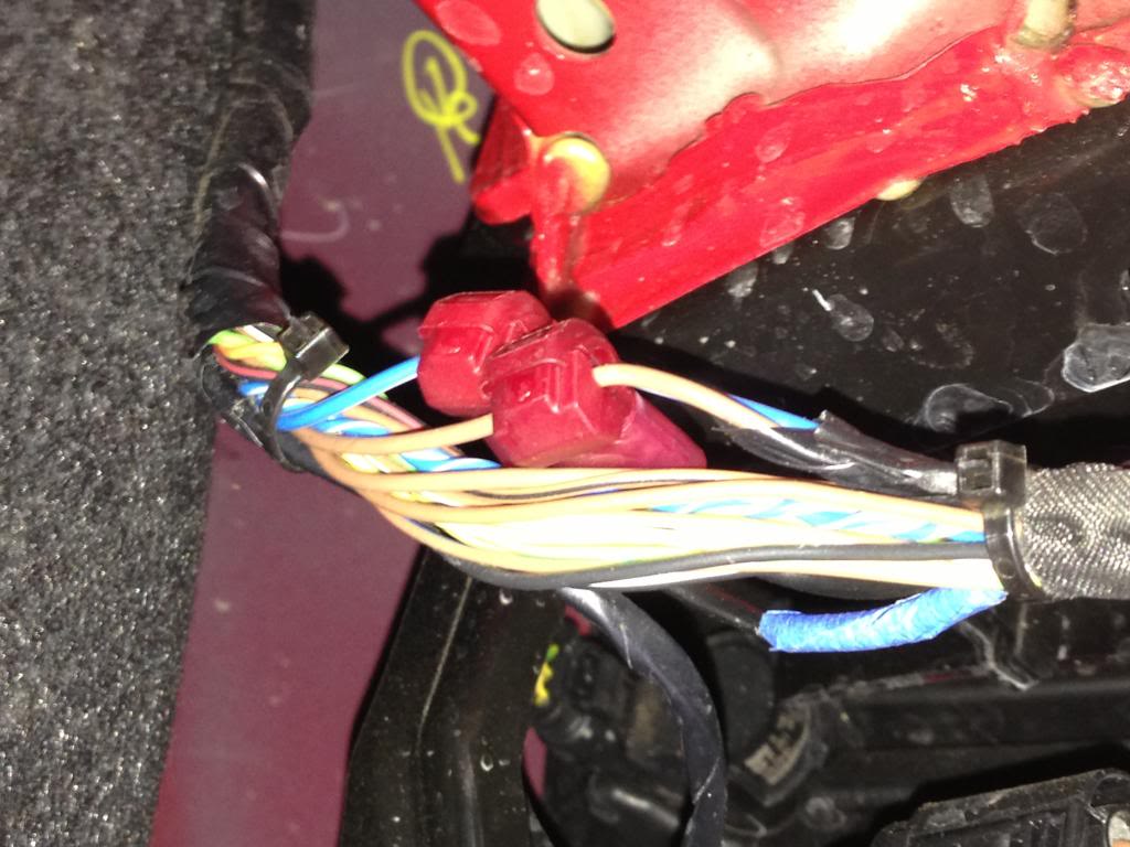

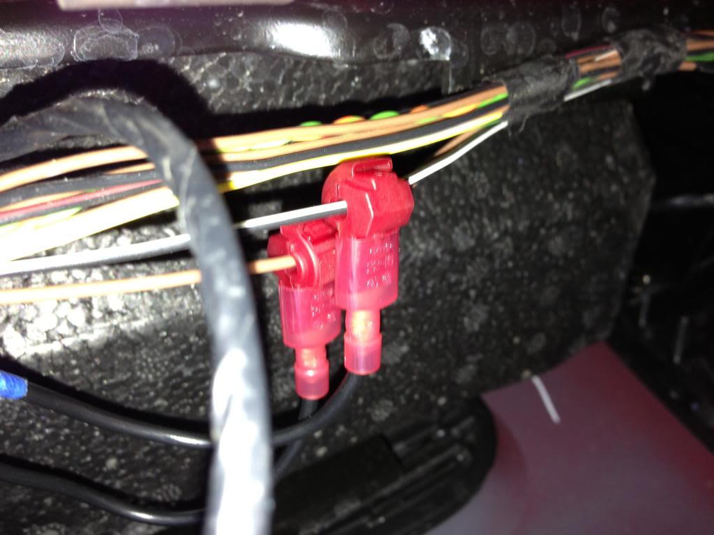

Another splice on the non-working side...

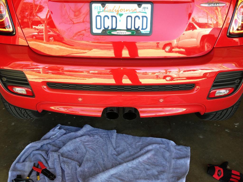

Finally -- I have functional Reverse AND Fog Lights!
I was finally able to complete this modification and achieve two functional reverse lights and two function rear fog lights on my '13 Roadster with JCW rear bumper. Thought I'd show the whole process here in case anyone else wanted to give it a try.
Here's a photo of the rear bumper in its "as delivered" configuration. Like all other LCI JCW rear bumpers, the car comes with a single white reverse light on the passenger's side and a single red rear fog light on the driver's side.
That led to acquiring a clear driver's side lens to achieve some symmetry. ECS and WMW, among other vendors, both offer this fixture.
The look is great...that is, when none of the lights are illuminated (see picture below). Since the wiring remains unchanged, you are still left with a single white reverse light on the right side. When the rear fog light switch is selected, as you might expect the left side comes on white. Since white lights on the rear of the car while moving forward is illegal in most states, the new white lens effectively eliminates the fog light functionality. On top of that, I greatly increased the number of people who would conclude that the left reverse light bulb was burnt out.
It was suggested earlier in this thread that an LED might work if the cavity with the white lens was separated from the rest of the fixture with the red lens. Alas, closer inspection revealed that the inside of the light was one complete volume. Back to the drawing board.
I happened to stumble across a provider of LED bulbs for automotive applications who had LED bulbs that illuminate in red. Possible solution! I then searched Ebay and discovered a set of LED sockets that I thought might just fit the bill:
Here's a closer view of the socket. Note that it has tabs that can be locked with a slight twist.
Here are the red LED bulbs. They were advertised as replacements for Mercedes exterior accessory lighting. They are CAN BUS bulbs with built-in resistors so that the car's computer "sees" normal resistance when it does its bulb health checking and thus the car doesn't constantly throw bulb-out error codes.
I fabricated a wiring harness with four strands of 18 gauge wire to run between the two fixtures (the painters tape is there so I could keep track of the wires).
Here's my initial wiring of the passenger's side fixture. I've used two Posi-Taps (I love these connectors!) to tap into the reverse light power and ground and run it to the other side. The two long white wires will eventually bring the fog light power and ground from the driver's side. I used some liquid electrical tape to make sure the ends of the Posi-Taps were well sealed.
On the bottom side of each light fixture I carefully drilled a 7/16 hole, then used a Dremel to cut two notches on either side of the hole to receive the tabs on the LED sockets. I also used the Dremel to shave the plastic and make it just a bit thinner since the thickness of the bottom of the light fixture was slightly greater than what the LED socket tabs could accommodate. Here is one of the fixtures with the LED socket mounted in place on the bottom side. Note that I used more liquid electrical tape to seal up the back of the sockets. (Later in the install, I used a bit more on the socket mount to ensure a good seal and to make sure the socket didn't turn itself back and unseat the tabs from road vibrations.)
Here is the driver's side with the wiring completed (the light is hanging upside down in this photo). The two left-hand white wires are the leads from the passenger's side reverse light, connected to the original bulb with two Posi-seal connectors. The fog light power and ground are connected to the LED leads with two Posi-seal connectors. I then used two Posi-Taps to connect the fog light power and ground to the two harness wires leading over to the LED socket on the passenger's side.
Here is the driver's side light fixture reinstalled. It's hard to see, but you can sort of make out the original bulb left of center, and the LED bulb sticking up from the bottom of the fixture to the right of center.
And here are the results. I had my wife put the car in reverse so I could get a picture of both reverse lights coming on bright and white. (Sorry, sort of a crappy pic. It had just snowed a bit and I think my camera lens was a bit fogged up...but you get the idea...)
And here are the red rear fog lights (the LEDs) illuminated. I like the pattern they project down on to the pavement.
All in all, not that difficult of a mod if you are comfortable with basic wiring. Frankly, the most challenging part is getting the fixture in and out of the black plastic surround without having the edges of the fixture scratch the plastic. That black plastic is soft and it would be very easy to put marks into it. Not a good thing if you're as OCD as me.
I'm very happy with the result, and not a single code thrown.
