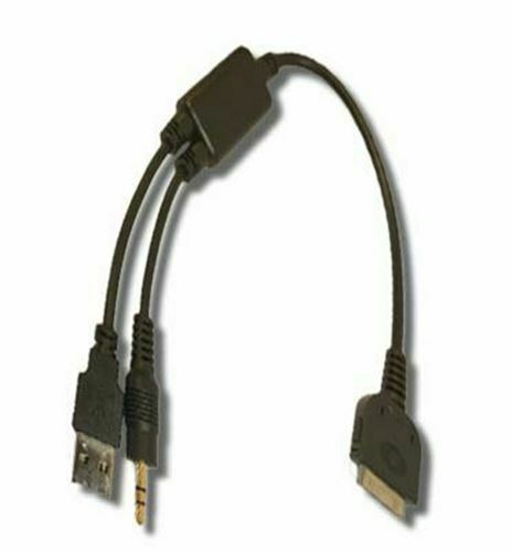

Hello,
I have been using multiple iPhones - 4s/5s/6s and iPhone SE with my 2012 Mini Cooper S for the past 11 years+. I use the original Mini Aux/USB to iPhone 4s cable, which looks like - https://i.ebayimg.com/images/g/f5wAA...GSc/s-l960.jpg

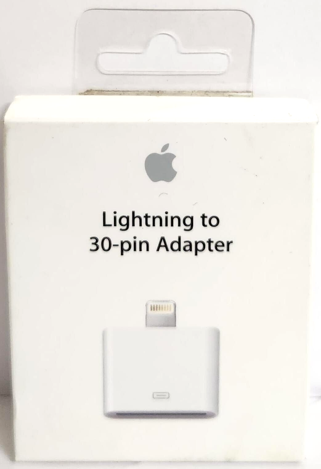

Since Dec 2015, I have been using the above with the original 30-pin to lightning adapter - https://i.ebayimg.com/images/g/k2oAA...zM/s-l1600.png
All of a sudden the iPhone tells me that the "accessory is not supported" and I cannot use either 6s or iPhone SE anymore with the car.

If the above doesn't help it leaves #3 as the most probable issue. And since you are saying it did work previously it's most likely that 30-pin-to-Lightning adapter is acting up. If you can get your hands on some old iPod or iPhone with original 30-pin connector I'd test the Y-cable to rule it out. If still nothing then replacing adapter or trying one of the bluetooth dongles similar to Tune2Air as mentioned by @njaremka. I too have successfully used one of those in my 2012 R56S for several years before I fitted CarPlay enabled stereo inside the speedo.

"30-pin-to-Lightning adapter is acting up" seems to be the real issue. I tried again with an older 30 pin to lightning adapter which supported sound and charging for about 30 seconds before flashing the same "Accessory not supported" message. I have used the newer (and original) 30-pin to lightning adapter for the last 6 years without any issue. It seems a case of wear and tear. Since this is now discontinued, I am going to buy a new Aux+USB t o lightning Y-cable.

I bought the following Y cable, amazon.com/dp/B099QHKD4W?th=1
It works absolutely fine, charges and plays audio. However, I only see the Aux & USB options on the display port now. Earlier it used to transition to IPOD and would show the audio/video metadata e.g. a YouTube video name or even a URL in case I played a video on a website. I guess that's a shortcoming with non-Apple equipment.
