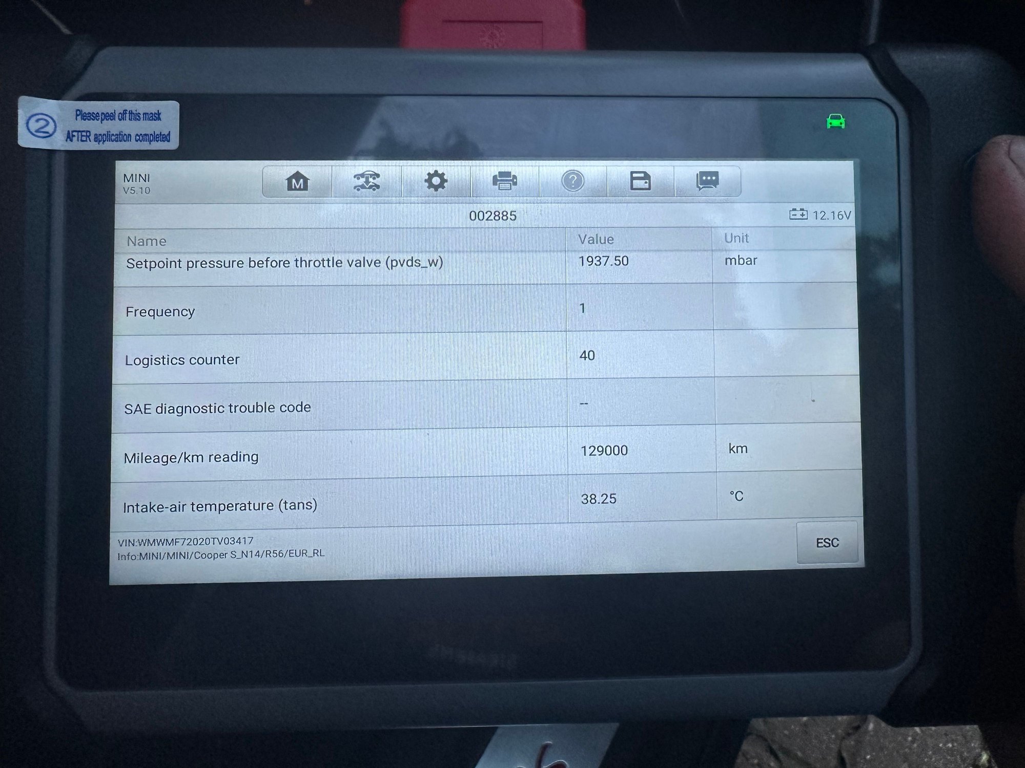

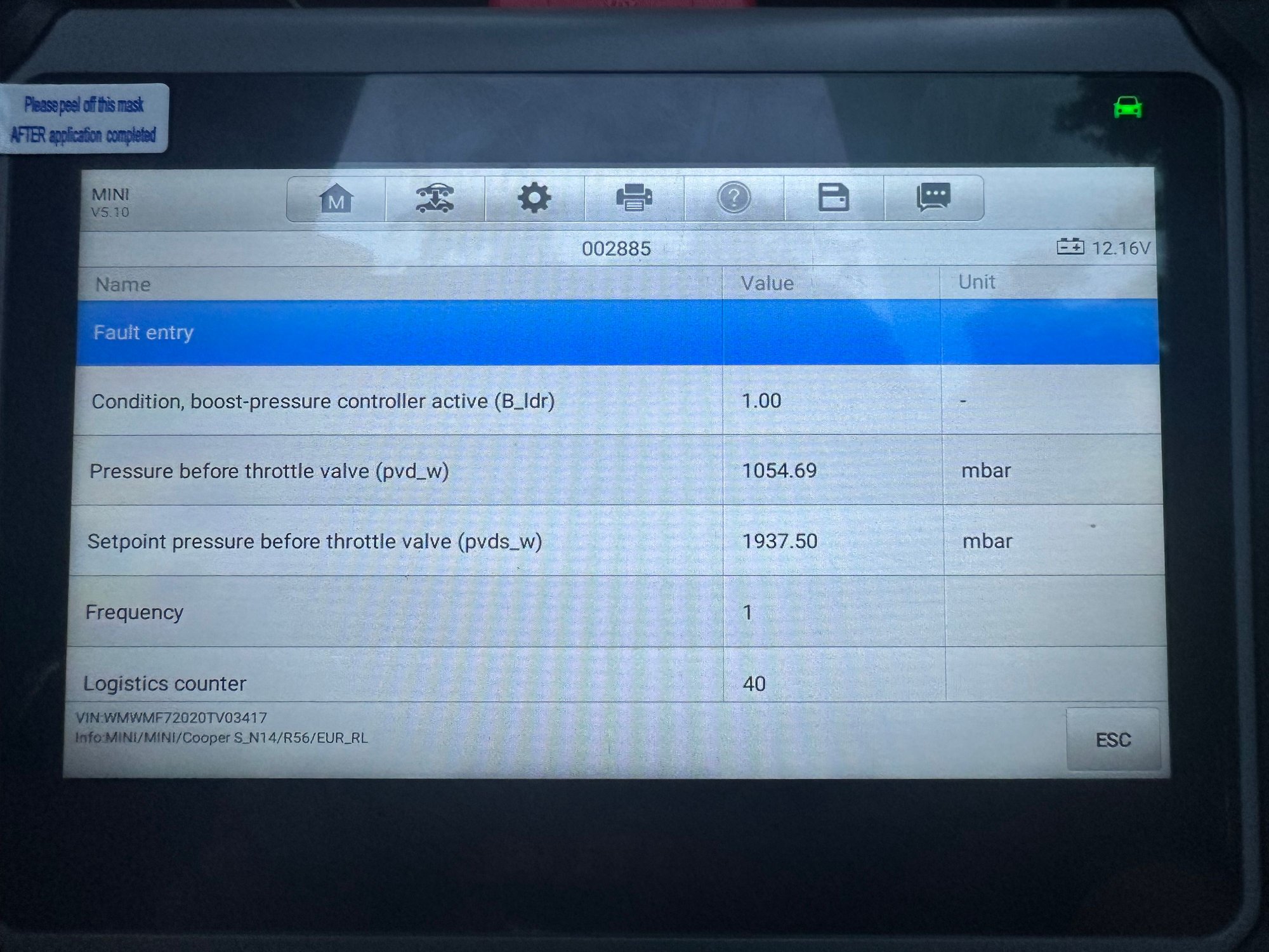

See freeze frame data below.

I don't see anything in the data you posted that helps.
