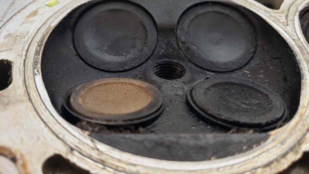

A word of warning about R56 N12, N14, N16, and N18 cylinder heads; they are notorious for dropping valve seats, especially after a valve job; Make sure you get all the valve seats replaced; also, the valves are so thin that there isn't enough margin left when the valves are ground; a good machine shop will tell you that. That means the valves have to be replaced if you don't have good sealing. And don't forget to check the height of all the lifters; the spec is listed on the Rock Auto "info" page for the lifter. The last head I installed had three dropped valve seats, and it got all new valves and lifters, but that engine had over 150K miles on it. I also recommend the ARP head stud kit; it a little bit of a PITA to install the number 1 cylinder head stud nut because you have to remove the #1 cylinder vanos spring (special tool required) to get a socket on the nut, but if the head ever has to come back off, you don't have to change the hardware again.
Dropped valve seat (N12 engine)
