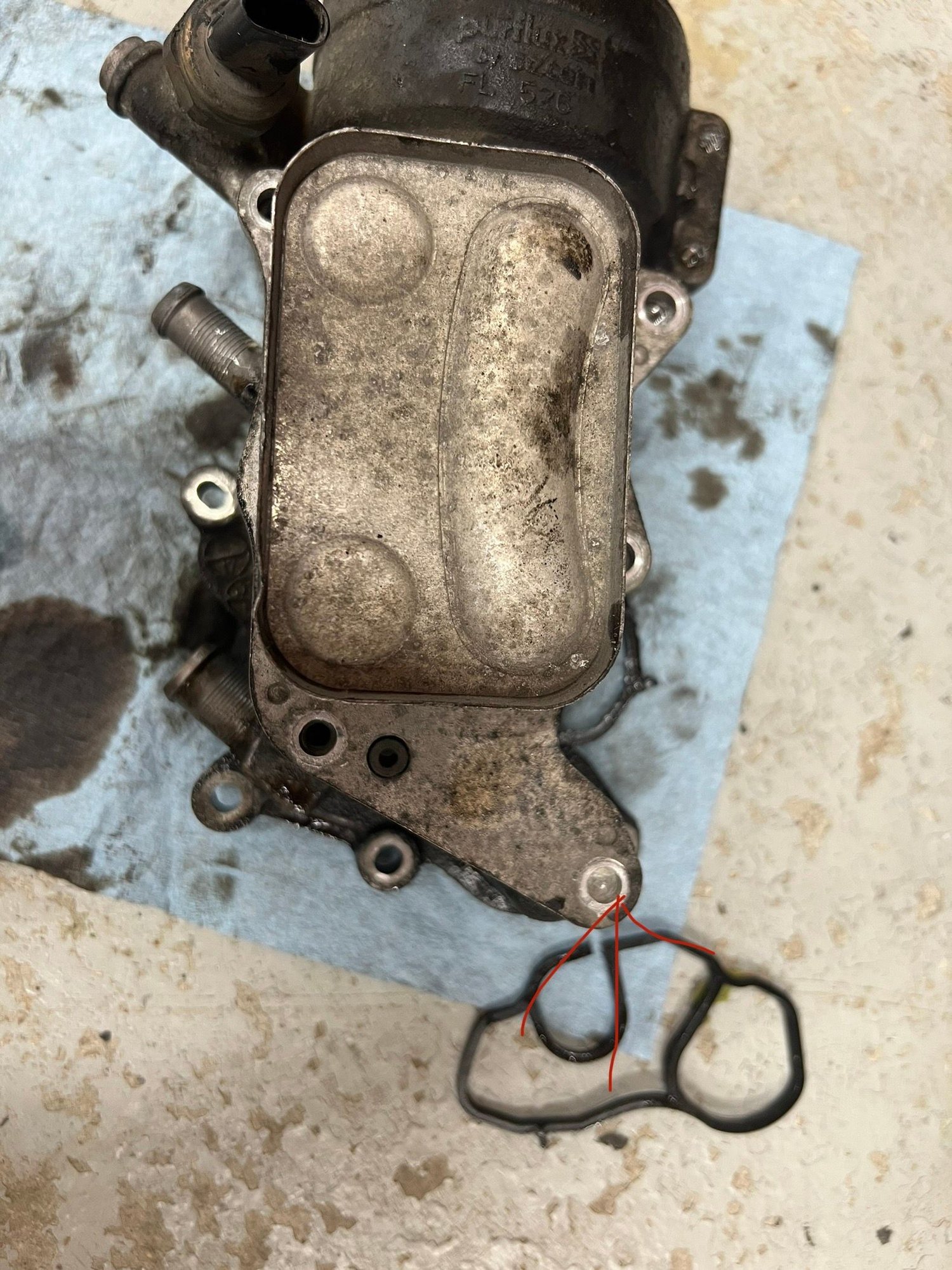

I swear my luck is never good. Last bolt to separate the heat exchanger decided to break 😑

A sharp drill bit in a drill press I have been lucky with drilling out bad bolts looks corroded?

Yeah there is definitely corrosion. I drilled it out heated it up then broke a tap. So now hopefully I can drill out the entire thing including the broken tap and ima try and helicoil it. I know the tap is hardened but with how small it is I might get lucky

They have a tool call EZ out you drill into the stud or bolt and it removes it.........

Lubricate!

Taps are extremely hard and drilling them out is almost impossible. I have had better luck with a hammer and small chisel busting them up in the hole. Never been able to drill one out.
Did you mean an EZ out, not a tap.

I tried that along with heat and the ez out broke….Continuing trying to get it out the housing cracked

The housing for the oil cooler?
taps once they break is nigh impossible.
lubrication
