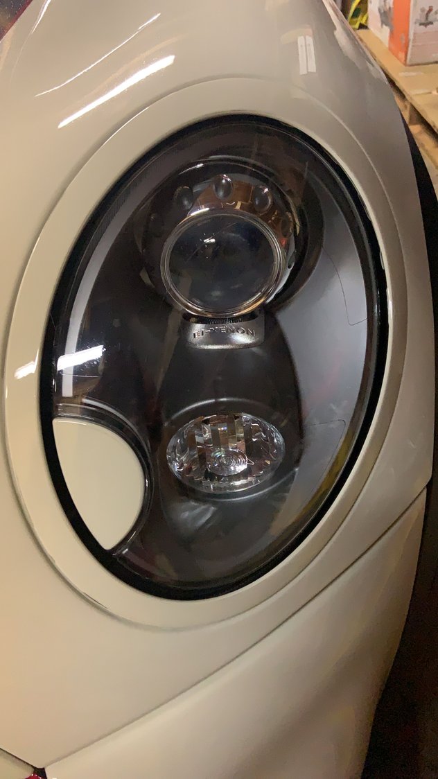

I posted this up a while ago.
Originally Posted by mountainhorse
I have this kit on a 2011 R56....
They are not "better" than performance of the factory H13 halogen headlights.
This "kit" runs a 25-watt HID bulb/balast ... which is noticeably dimmer than both the factory HID with 35-watt bulbs... or the factory halogen bulb...
Factory halogen equipped R56’s ... I got a better quality, DOT/SAE H13 bulb like the Sylvania Silverstar Ultras… light as well, or slightly better, than the HID 25w kits IMO
If the lenses on your Headlights are clear (easy to polish and protect if not).... and you have good bulbs in there that are aimed correctly.... you will have a great setup.... I don't recommend LED bulb replacements either... most have poor beam patterns... and really not ‘better’ ... and are costly
Most people buy this kit for the 'looks' ... not because of the lighting ability or lack thereof.
I have seen this HID kit equipped with the 35-watt Morimoto D5S bulb/ballast upgrade... but that cost is around $350 for the bulb/ballast assemblies for both sides.
https://www.headlightrevolution.com/...S_2?quantity=1
There are cheaper 35w D5S bulbs out there... but they are just that ... cheap.
Are they cool looking ... sure.
Worth the money in terms of lighting.... Not in my opinion.
For looks, this kit is definitely an upgrade.
And…
If you invest in full 35w D5S assemblies… they will come close to the performance of the factory MINI 35w HID Xenons
My 2¢
Halogen:
Bi/Xenon darker retrofit ‘Titanium’
AND....
I can understand where people may see "greatly improved"
But I stick by my evaluation.... Side by side... both same year cars... Halogen vs this upgrade HID kit.
I found the beam pattern to be improved, especially in terms of crisp cutoff... but overall lighting down a dark mountain road with low beams... not so much "improvement" as detailed above.
The halogen high beams with with nice clear OEM housings and the DOT/SAE-legal upgraded capsules.... I found much more effective lighting than the upgrade HID kit on "high beam" .
Again... I am comparing fresh upgraded off the rack DOT-approved Silverstar Ultra halogen capsules in near new (clear, not fogged) OEM halogen light housings. .... and NOT 'tired' stock halogen capsules with fogged lenses. Many people upgrade to this kit after their stockers have some serious age on the capsules and fogged lenses... and I can see where a vast improvement would be seen.
This is my take...and only one of many valuable opinions out there.
Other vehicles that use the 25 watt D5S bulb, like Silverado pickups have many wanting better performance out of their lights.
A couple of big reasons that MINI went with a sub-industry-standard (for USA) 25 watt D5S...
-Easier integration
-Meets the Euro standards for headlights.
After seeing just how much better the 35watt Morimoto HID upgrades were in my friends Silverado... I'll be upgrading to them for next summer with other maint/upgrade items planned.
On the other hand.... the 2011 MCS with MINI-factory 35W HID's, and housings that are a little different... have MUCH better overall lighting performance than this kit, IMO, and/or the factory halogens in my opinion.... side by side. I wish that MINI offered an upgrade to the factory housings.... but understand that would probably have been a nightmare with install (levelers etc)
This IS a very nice quality kit with great projector looks though... the car does look better IMO with the kit.
ECS's price on this kit is PHENOMENAL!
I will probably be buying a spare set to have in case I loose one on my car from rock or other impact as they will not be available as spares in the future since this kit is being phased out. The kit in my R56... LOVE the looks and the beam cutoff ... looking forward to bringing the light output and performance to near that of the factory HID-projectors as installed by MINI with the same-as-factory-wattage (35w) modules.
