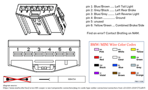

I mean rear light (not front light)
I connect wire with Pin 3 (12v) and pin 4 (ground), but everytime brake will light turn on.
any solution?
