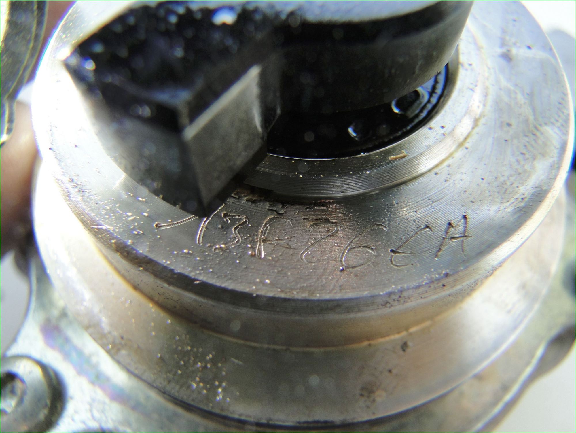

I just purchased a new HPFP for my 2011 Countryman S ALL4 with a little over 91K on the odometer. I purchased the Mini in Feb. of 2021. I replaced the pump with an OEM purchased from FCS Euro. This is my first purchase from them.
Upon examination, it seems the pump I replaced is aftermarket. It's my understanding that the OEM has a QR Code on it. The pump I pulled seems to have something inscribed on the journal.
Sorry about the large photo. Doesn't seem to be a way to shrink it.
Are my thoughts correct in thinking this is aftermarket?
D

Originally Posted by harleydood
I replaced the pump with an OEM purchased from FCS Euro. ... Are my thoughts correct in thinking this is aftermarket?
Which definition of "OEM" do you go by?
https://en.wikipedia.org/wiki/Origin...t_manufacturer
As far as I know (and please do not quote me on that), the HPFP fitted at factory were either made by Bosch or Continental. Whether or not BMW/MINI (or Peugeot/Citroen for that matter) ever sourced their aftermarket parts from other pump manufacturers I don't know.

FCP Euro has a nice video explaining the difference between the OEM and aftermarket HPFP's. They also claim in the video that they get their pumps from Citroen.
I opted for the "Genuine" "PSA" version (the "P" stands for Peugeot), which was $908 delivered (NOT what I would call a "cheaper alternative").
When I watch these types of videos, certain things will raise flags. This video and its claims seem genuine to me.
Thoughts?
D

Posts: 36,724
Likes: 2,537
The pump we have is PSA (which they share the brand under Continental/bosch) Made in the Czech Republic for PSA and MINI shared engines, we had it before long before most places. This was back in 2018 PSA is shared engine with MINI and Peugeot / Citroen Prince engines.
It had a QR code on the metal last time I checked and in our pictures it shows it.
Just pulled one from shelf and it has the QR code.
On the box it will say Genuine PSA Original Parts.
At the Factory they go down the same line, might get a different QR code and stamping and one goes in Genuine MINI Box and others go into a Genuine PSA Groupe Box based on production order.
