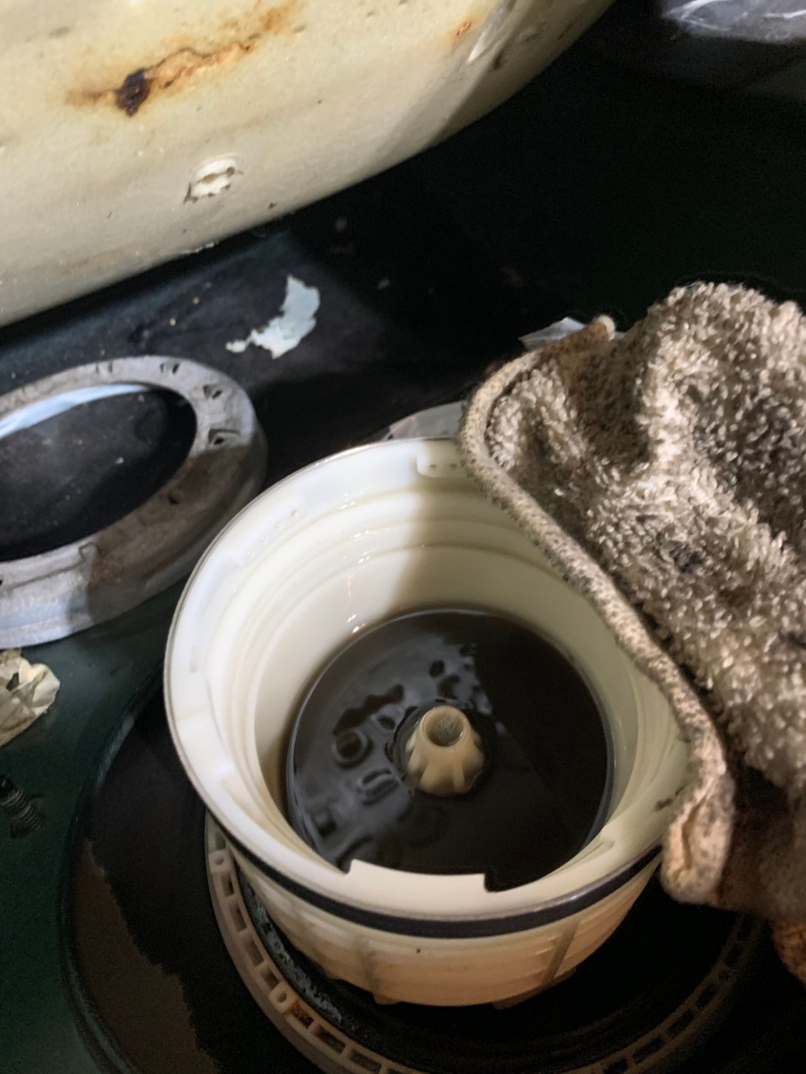

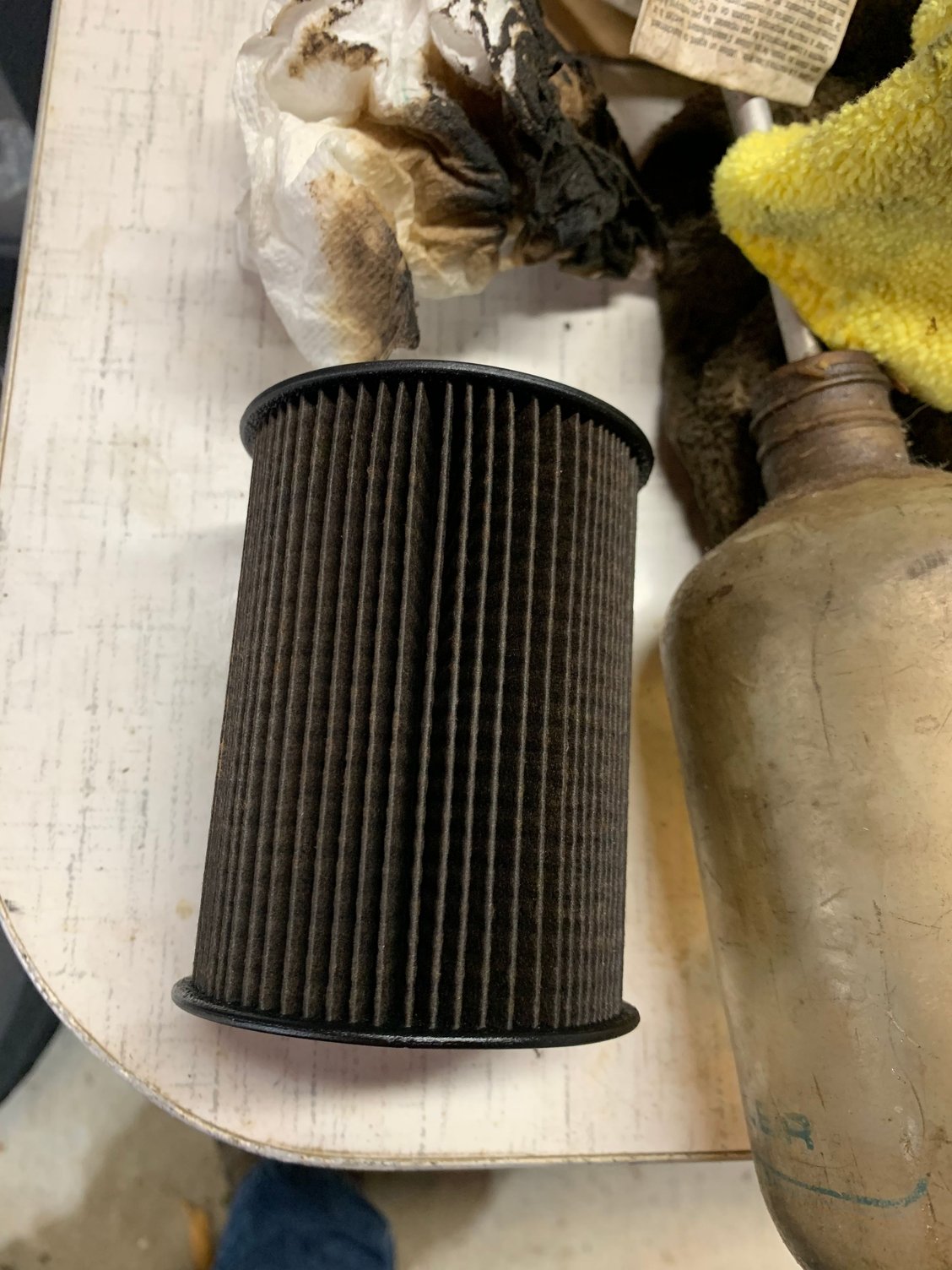

as a last ditch effort, I replaced the fuel filter again since it had about 20k miles on it. Last time the new fuel filter made the problem go away for a few months…..this time it didn’t help…..but…..When changing the fuel filter, I did notice the fuel in the filter housing was very dirty / black and the fuel filter was black. I didn’t expect the filter to be black already since it’s only 20k miles old.
the fuel in the tank looks normal.
Filter with 20k miles vs new filter
Fuel from filter assembly
Fuel in tank
Fuel in filter assembly

My guess is that something in the pump is deteriorating and putting all that dark material into the fuel filter housing.
This is just a guess….but something is making that fuel dirty and for $370 I’ll take the chance instead of troubleshooting for another 8 hours.

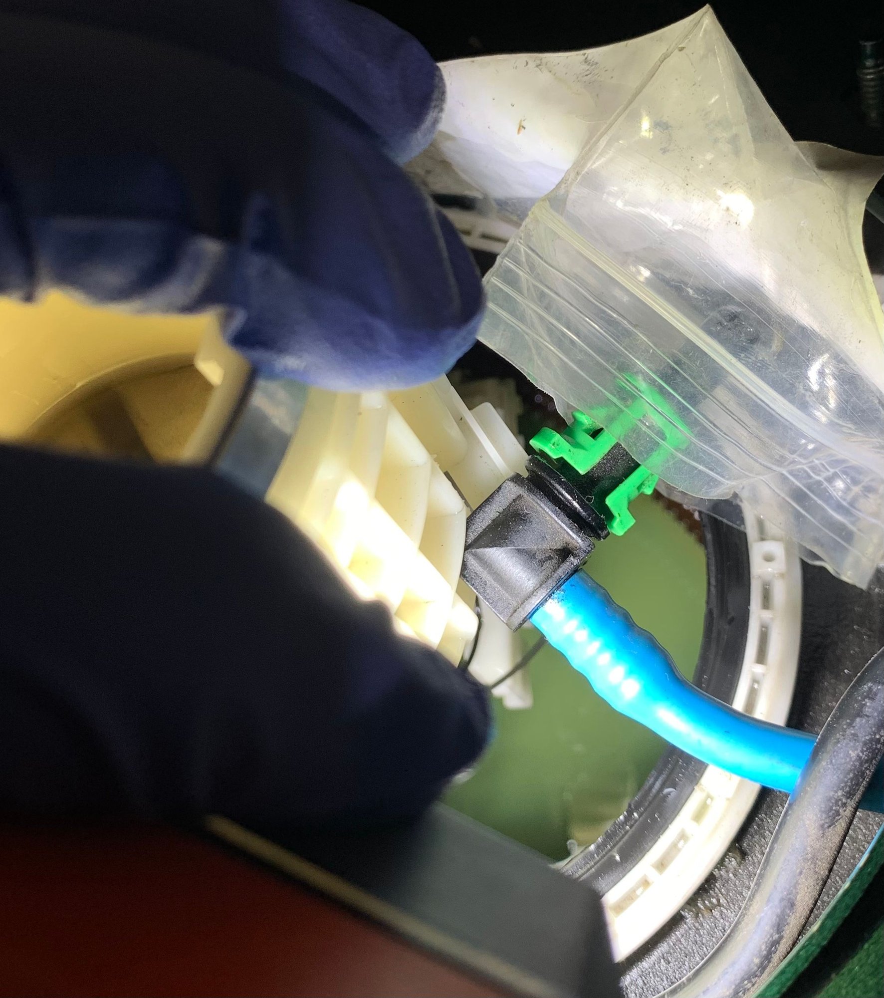

1 - replaced the in tank fuel pump. Didn’t fix the running issue but the new one sounded WAY better than the old one….so the old one needed to be replaced.
2 - went to replace the HPFP. Bolted the new one in, but before hooking the fuel line to it, I decided to take a look at the fuel that was getting pumped to the HPFP.
Under the hood, with the fuel line disconnected and pointed into a mason jar, I opened the door to pump some gas into the mason jar.
I looked at the fuel and saw some small black particles. Not a lot….just some.
3 - I went back to the filter assembly to check for dirt. The assembly and filter were all clean this time (I’ll check the old fuel pump later to see if it was really degrading and creating the black particulate).
I connected a hose to the fuel filter outlet and rigged up a battery / button switch to turn on the electric fuel pump.
I pumped a few mason jars of fuel then it finally started coming out clean.
I then went to the engine compartment and pumped out a bunch of fuel there to flush the line. It took about 6 or 7 mason jars of fuel before the fuel ran clean.

Filter assembly is clean now
Filter is still clea
Pumping fuel from the tank
DIRT!!
MORE DIRT!!
