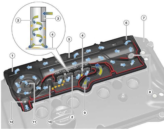

Regarding your catch can, I was able to dig this up which seems to indicate it's totally not worth it.
The N13/N18 engines have an oil separator built into the valve cover, #2. Blow-by gases come up through #9, go through the separator and then take one of two paths depending on whether the turbo is producing boost or not. Under boost the gases escape through #12 and go to the intake duct upstream of the turbo, where there's enough of a vacuum generated by the turbo to pull them through.
Under non-boost, the check valve at #12 remains closed and all the gases go through 1, 5 and 6 which feed directly into the intake ports.
So if you install a catch can it will do absolutely ****-odd 90% of the time. The other 10% (under boost) it will only serve to catch the very small amount of oil the separator missed.

Originally Posted by mrbean
The N13/N18 engines have an oil separator built into the valve cover ...
What is the source for this (that the above information applies to the N18 engine)?
Note:
a. the above graphic does not show an N13/N18 engine (just FYI, this means nothing in regards to whether the information applies to any one engine).
b. BMW/MINI in Germany quote exactly the same price for valve covers for N12, N14, N16 and N18 engines: € 313.70 (with the N12 and N16 sharing the same part). If the valve cover for the N18 had such an oil separation mechanism, I'd be very surprised if BMW didn't price it higher than those for N12/N16 and N14 engines.

That diagram is for the BMW N13 Engine:
https://www.forumbmw.net/topic-440-l...r-bmw-n13.html
Only difference is the N18 engine has the vent tube connection on the opposite end.
Just because the valve covers are priced the same, doesn't mean they are the same...
https://www.ecstuning.com/b-genuine-...r/11127646555/
https://www.ecstuning.com/b-genuine-...r/11127646552/
Same list price even in the USA, but different reseller discounts.

I should have phrased my question better:
Your mrbean's post suggests that the N13/N18 have an oil separation mechanism which the N14 (if not also the N12/N16) lacks (and thus an oil catch can makes sense for the N14 engine but not the N13/N18).
Is there any information available that shows this (i.e. that the N13/N18 is separating oil fumes in a way the N14 does not)?
PS.: I didn't claim that the valve covers are the same, just because they are priced the same. I meant to say that them being priced exactly the same, it would surprise me if one of them comes with such a feature while the others do not.
