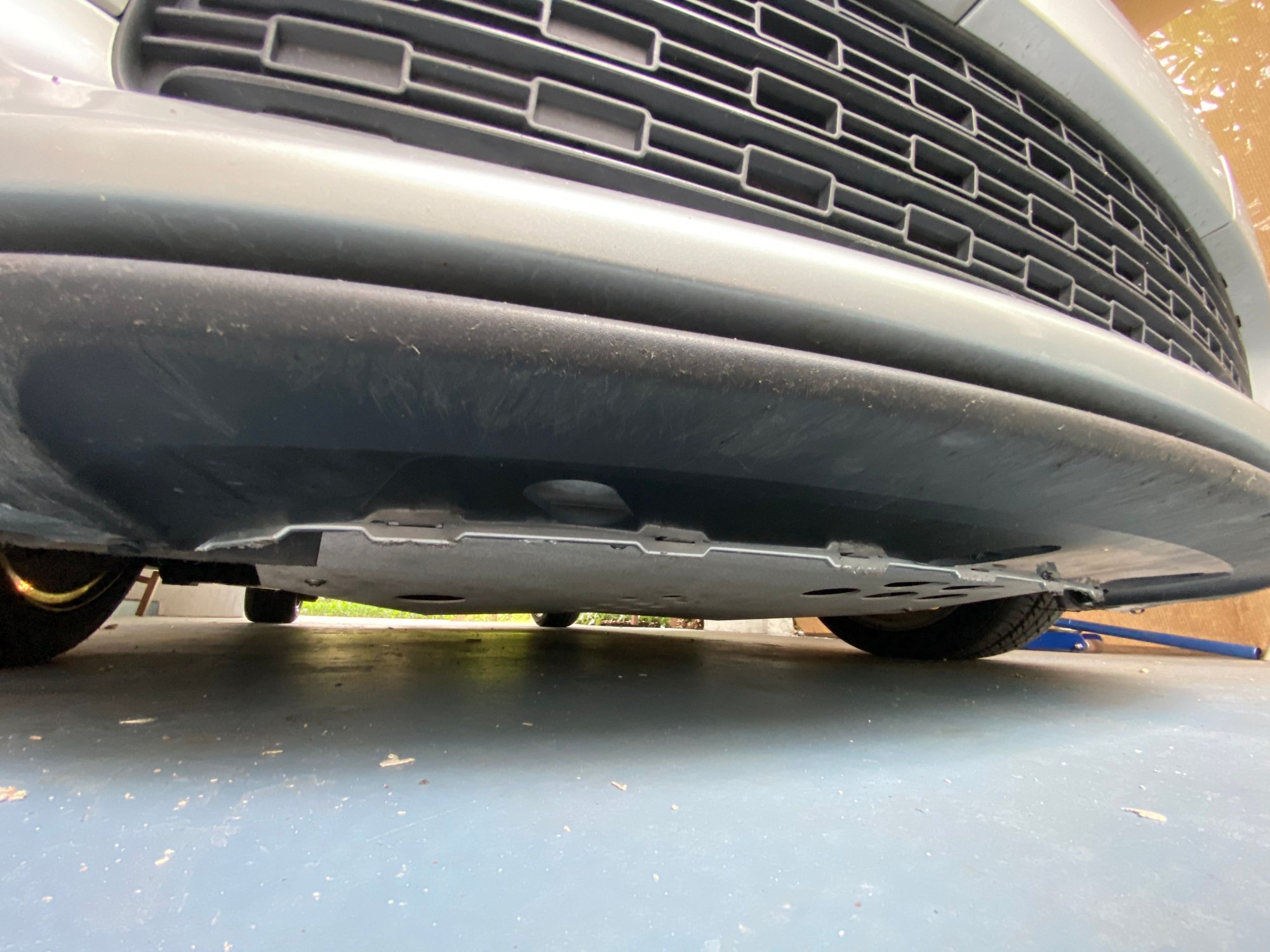

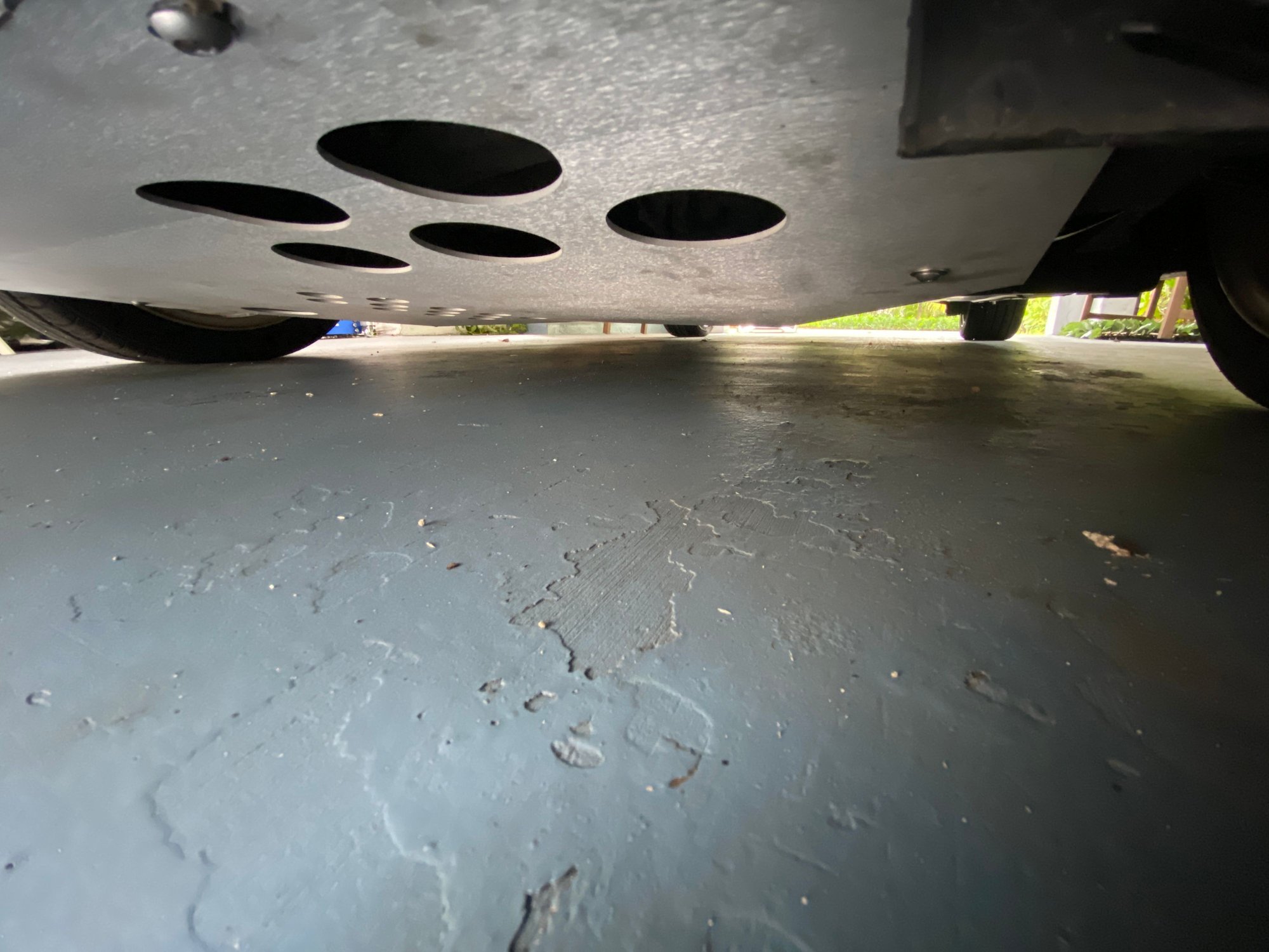

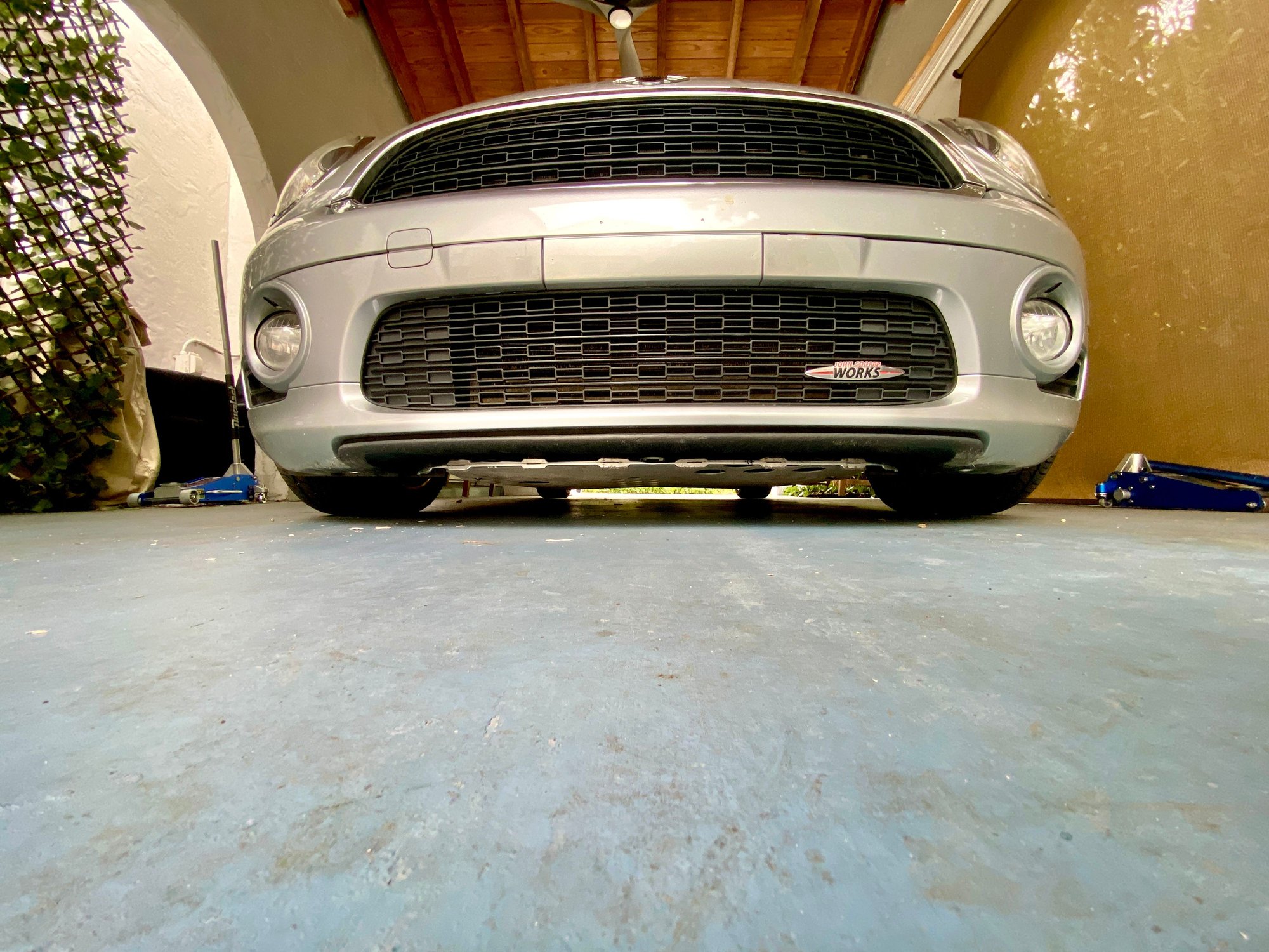

One of the first things I did after purchasing my R56 a couple years ago. It has saved my car on several occasions.
gorgeous! Maybe some folks will offer used ones in decent condition in 2025
