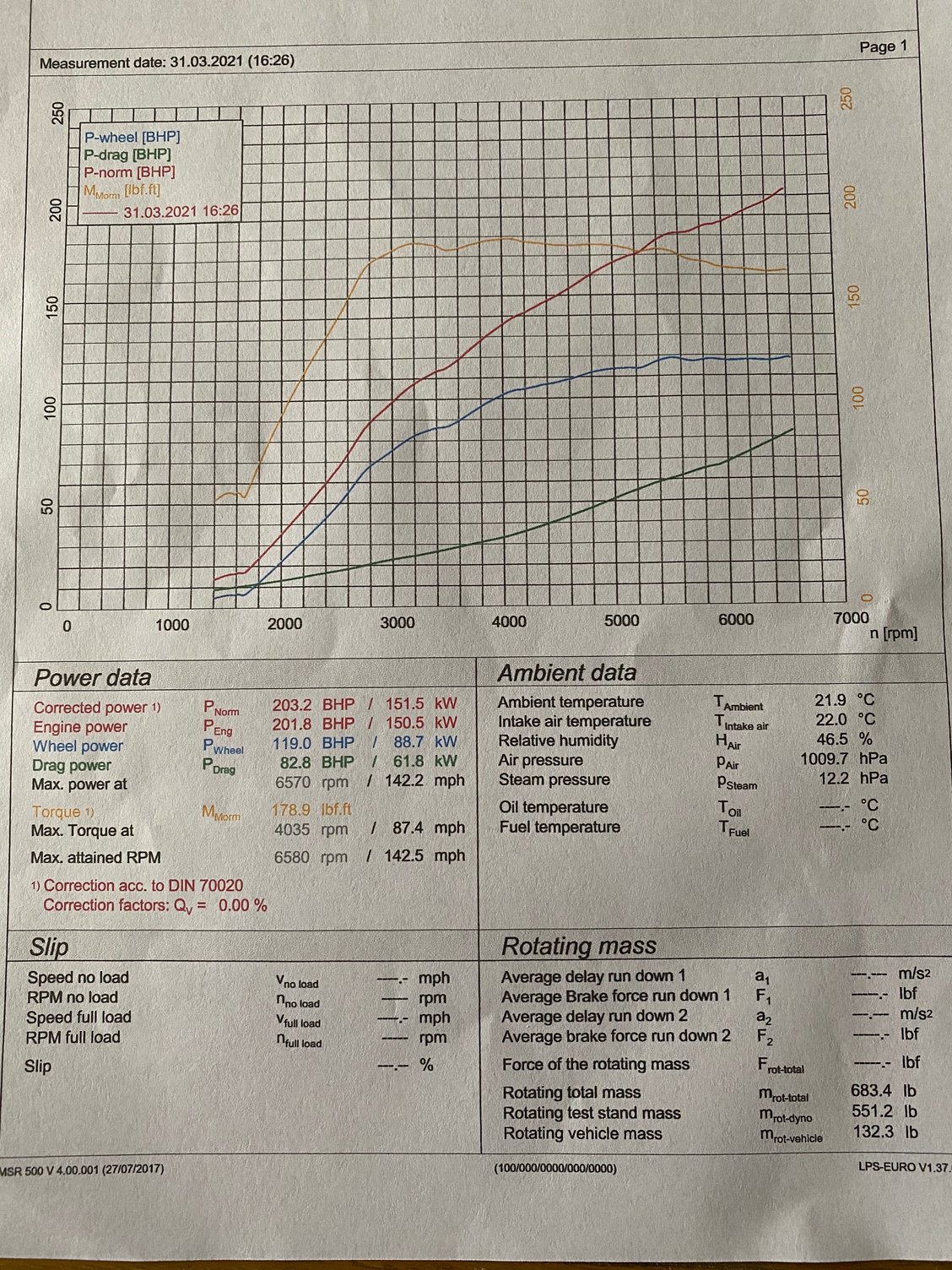

cheers; fair point, would be a much cheaper route if for some reason the new file had not actually mad it on and that this is the issue. Have flagged
Dyno figures ... torque and whp well down as you can see

Something is massively out of whack here. The dyno chart shows wheel HP @ 120, a drag HP ~80HP(what is that about?) A stock N18 in good health should make about 165WHP.
At a minimum it sounds like your faith in your tuner is misplaced. I suspect in addition to the problems with the engine, the dyno has not been correctly configured.

Get a code reader that includes live capture of data and monitor MAP. There no way in this, or any other solar system, that you can produce the dyno chart you have, and have stage 2 appropriate boost levels, and have an appropriate tune in the ECU.
You have some combo of:
Dyno not configured properly
Bad tune
Tune not loaded correctly or at all

The OP's complaint is consistent with the dyno chart.
Pretty clear there is a problem.

I think your issue is with the dyno, then. As was mentioned, those numbers don’t even match up with a stock Cooper S.
What levels are you seeing for boost pressure? Are you monitoring boost?
