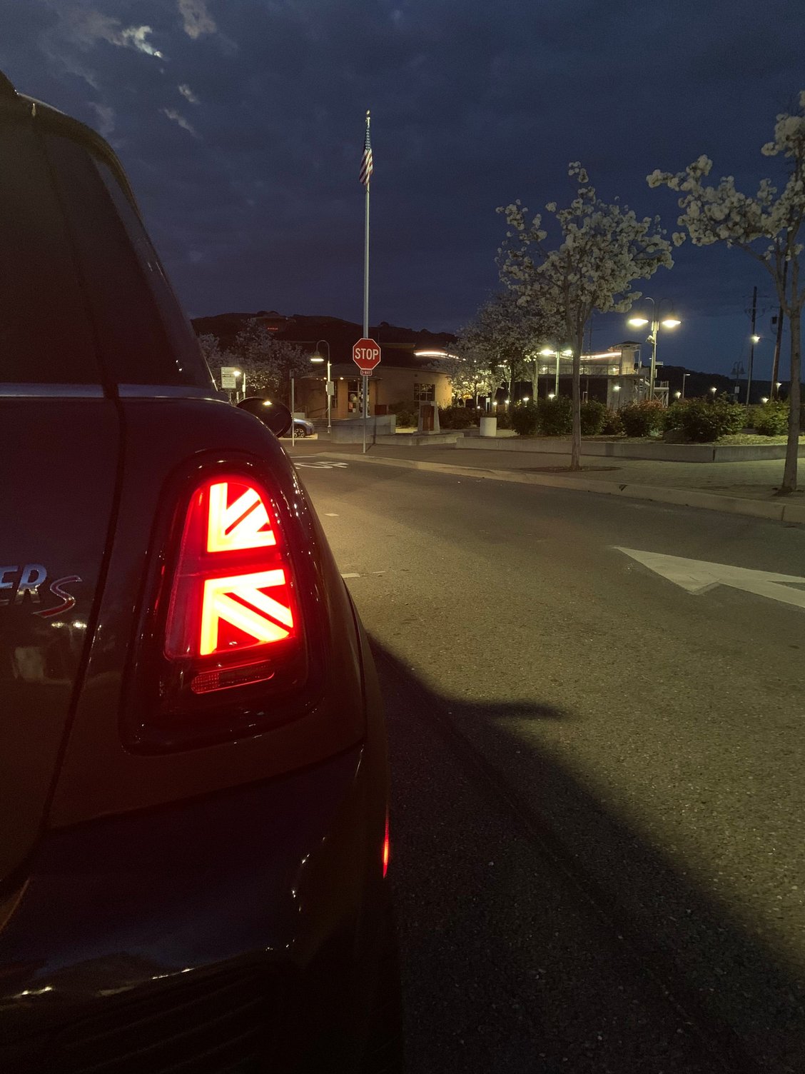

Does anyone know if these tail lights will be plug and play for a 2009 mini cooper s or will they throw error codes or something?
Helix Union Jack Tail Lights
I really like the look of them.

looks like one plug on the back of the unit and a handful of torx around the perimeter. shouldnt be any issues

Yep plug and play for the year you have R56/R57 model.
I installed these when they cam out, i have the 2011-2015 set.

No codes!
