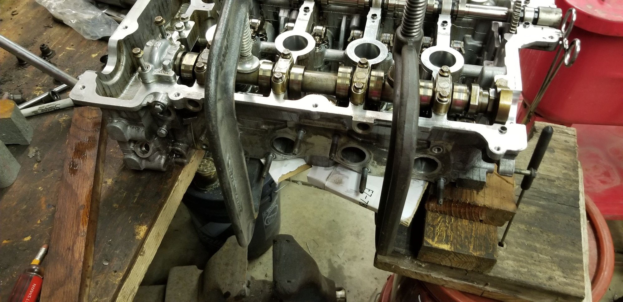

Old Jul 12, 2020 | 08:38 PM
outlawspeeder's Avatar
outlawspeeder
Joined: Jul 2019
Posts: 37
Just a quick notes on the rebuild.
I did a simple port job on the head. Just to get the casting crap out and to slow the carbon build.
I order all new valves. I found two intakes valves that the dome what not centered (just odd) and an exhaust vale that when I check the runout on it was bad. Time I priced out the three, I could get all for 10 more dollars.
If you look at one of the photos you'll see a pair of hemostats. I wear size XXXL gloves and there tight. I couldn't pick up the keepers for the valves. When you put in the new valve using a "c" type valve tool with screws wrap something on the part that goes on the valve. It is just a good thing to do.
The n12 cams are loaded. This means when you reinstall the cam mini is uses a clamp to push the cam into the head. I used two large C clamps with cardboard on the surface.
I used the two wrenches, rod, and spacer to roll the springs over to remove the bolt photo below.
Cleaned everything.
If you're going to do this watch this. Also be carful not to cross thread the bolt. When I did the torque I held the spring down.
Do not remove this bolt without a way to hold the spring!!!
Cam installing without the mini tool.
https://www.newtis.info/tisv2/a/en/r...shaft/JkeeEEqo
