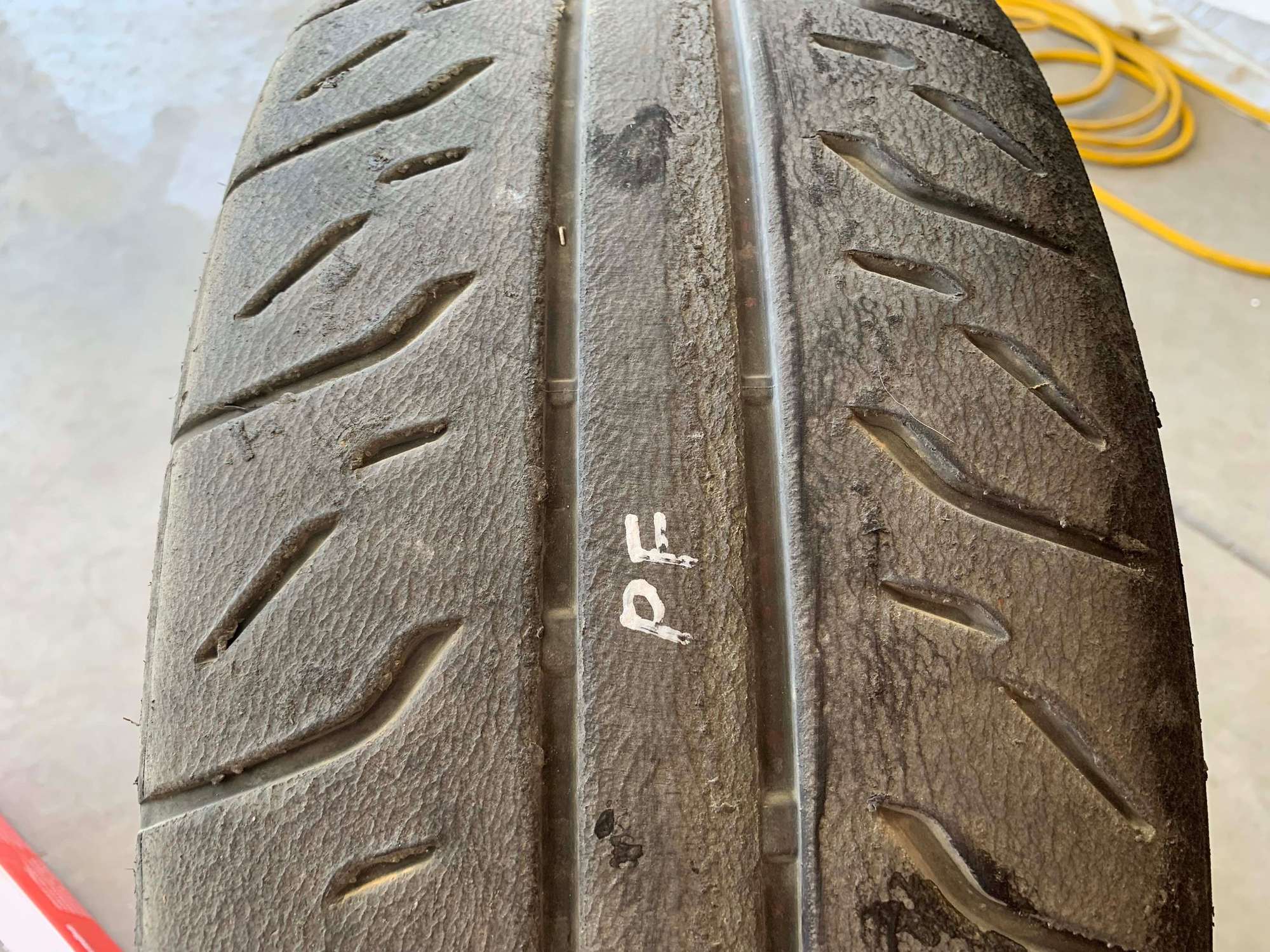

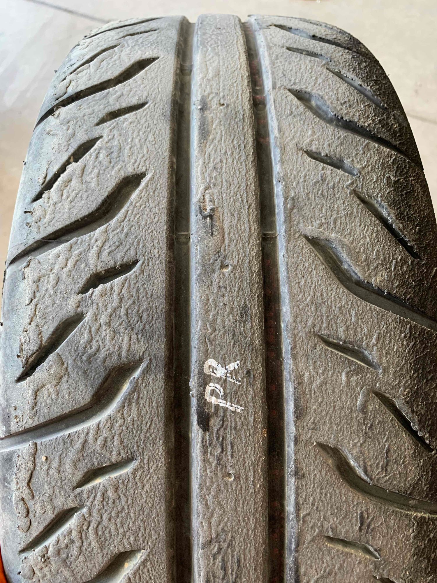

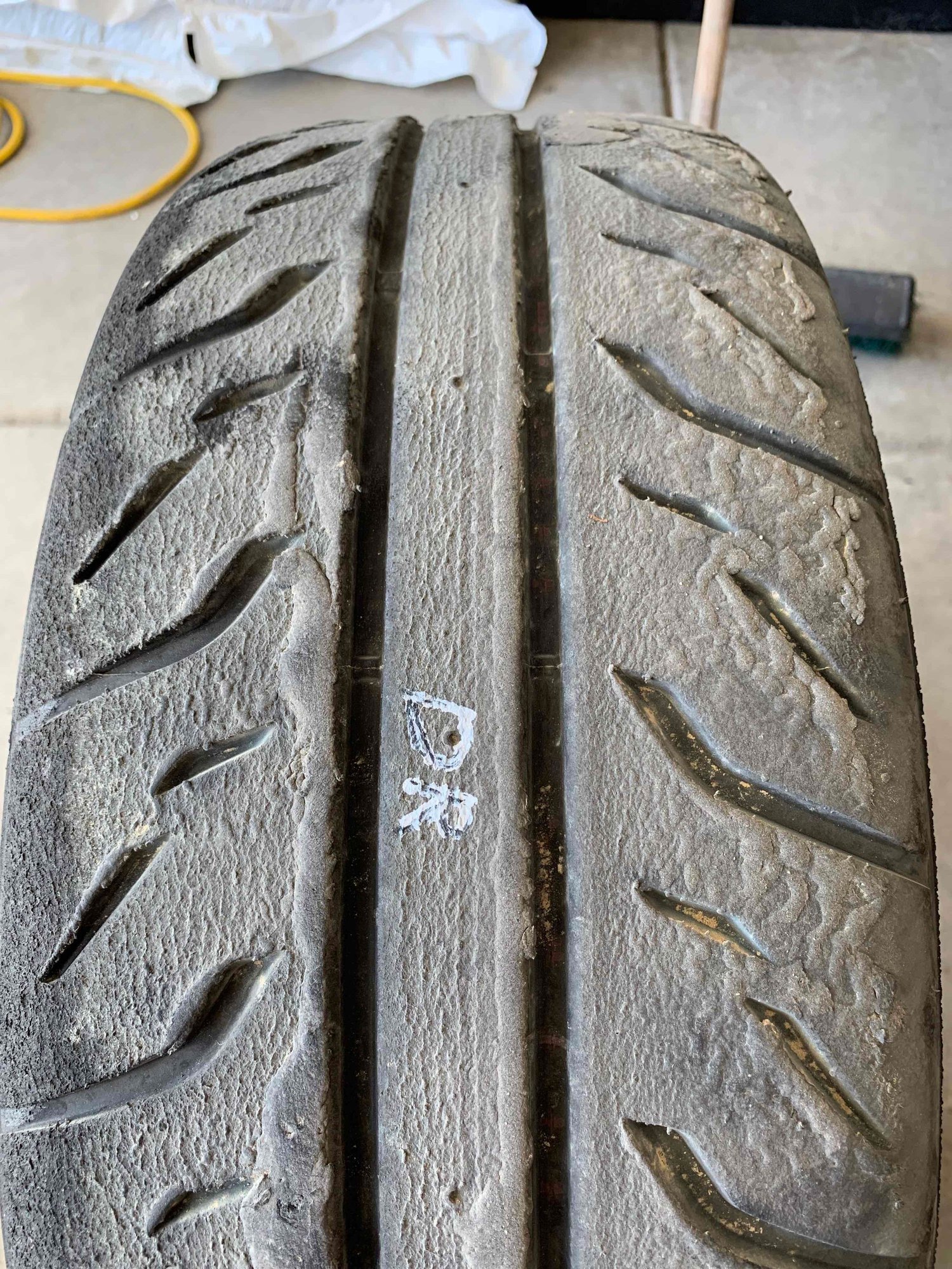

I was running -1.9 degrees of camber front to back and 0 toe in the front with 1/4" toe in for the rear. I found 30psi front and 28psi rear cold to be the best for this setup according to tire temps. I could have used a bit more camber but didn't find out till too late in the day. Tire temps with DTC/DSC on were pretty good but with them turned off it was clear I needed way more camber, which is evident by my tire wear. Unfortunately I think I killed my DF tire, which was probably at 50% when I started the day, I may be able to rotate it to the passenger side and get a bit more out of it but the shoulder is pretty toasted.

The shop that does my alignments only trusts one of their guys to do them with the camber plates etc so that locks me into doing them on Saturdays only, tough to set a track specific alignment before a day on a Saturday then so I ordered up some equipment to do them myself. Judging by my tire wear I'm thinking I'm going to need 3 degrees in the front and 2.5 in the rear. Also planning to drop rear toe in to 1/16"

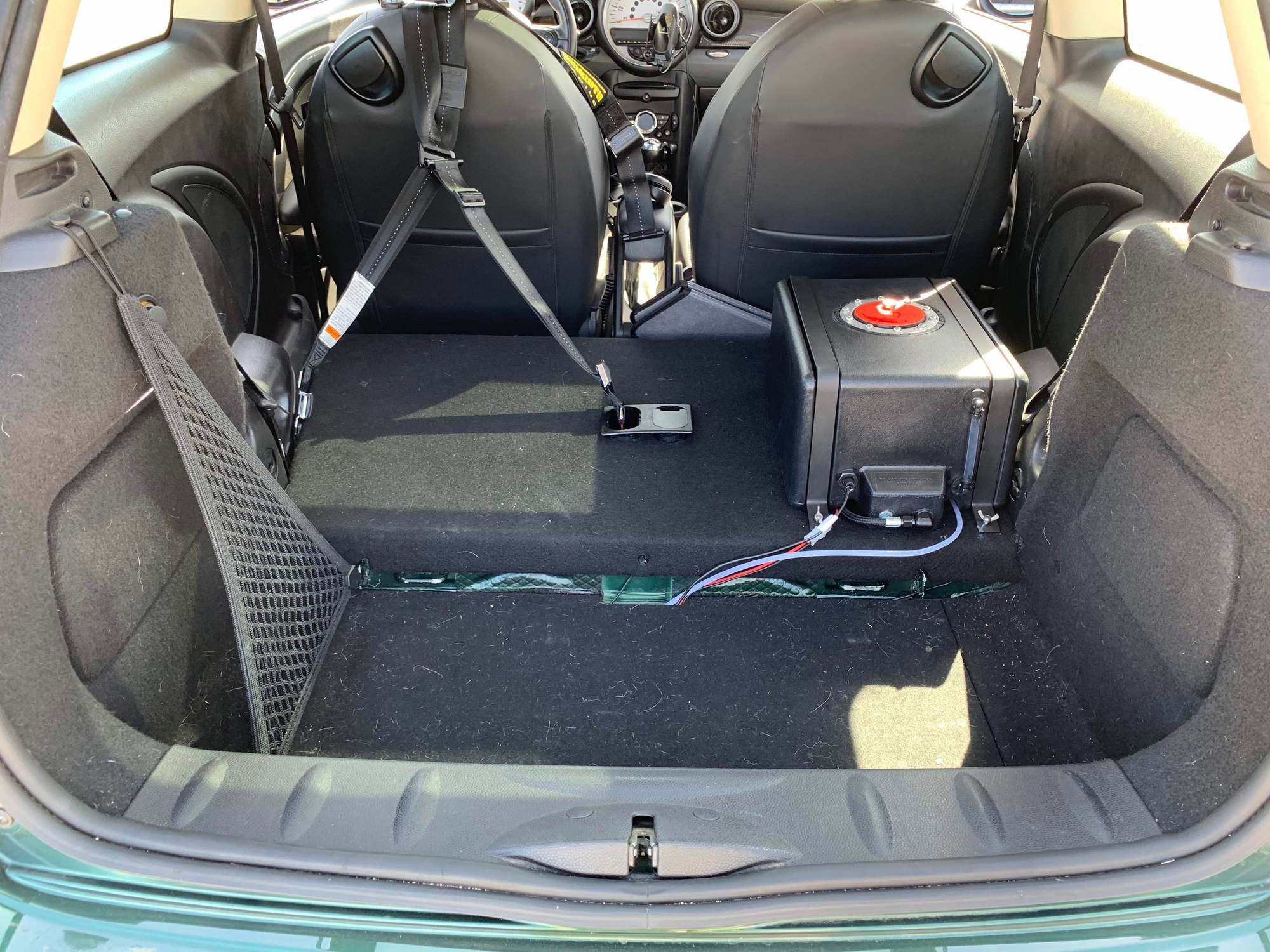

What kind of methanol set up are you using. Just heard that running meth at the track is the way to go with keeping your engine cool and track times consistent.
Old Oct 7, 2019 | 07:34 AM
Cab00se's Avatar
Cab00se
Joined: Nov 2017
Posts: 192
Likes: 25
I’m running an Aquamist HFS-4 with a 50/50 water meth mix. I don’t have a datalogger so I can’t say for sure but when i was checking intake temps on some sessions I never saw them go above 160 and it was a 100 degrees out.
