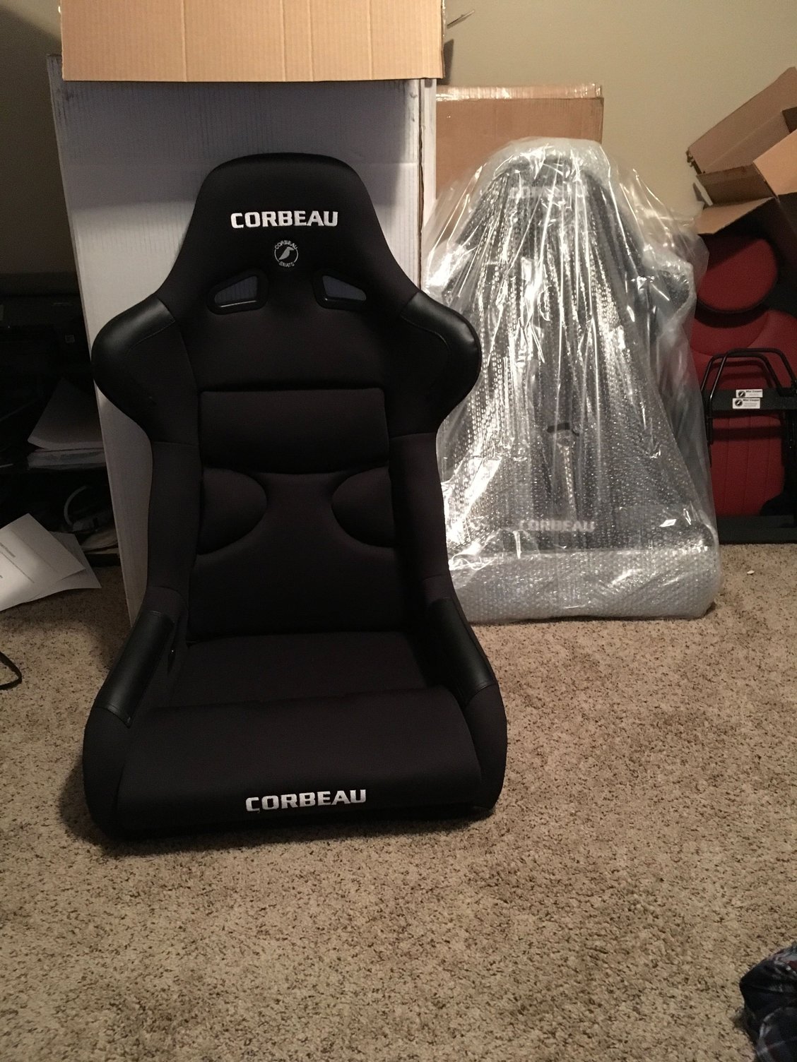

Nice seats!
I moved the passenger occupancy sensor from my old seat (09 R55 punch leatherl to my new seat ('14 f56 Sport), and it worked for about two weeks. Since then it thinks that there is always someone in the seat, so I just have a CravenSpeed Chimex plugged in unless someone is in the seat. I think the reason that it isn't working right is that the seat base shapes are very different and I had a hard time getting the sensor to fit the f56 seat. If I were to do it again, I think that I'd try just leaving the sensor under the seat.

Did you get your new racing seat in yet? Those are nice.
Old Feb 27, 2019 | 07:38 PM
BigBoost's Avatar
BigBoost
Joined: May 2015
Posts: 583
Likes: 30
From: Eau Claire WI
no I haven't yet.
waiting on my roll cage
and a few other things before I start to install
