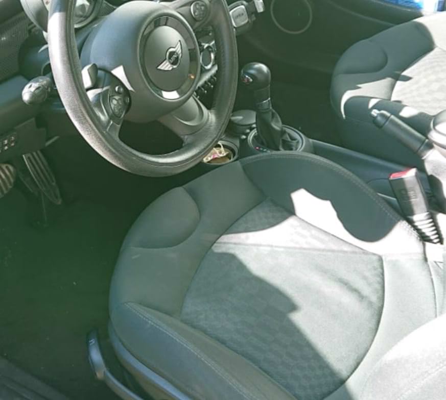

I think I will stay with my N18 MCS
Is there anything I can do with the crappy seats? I REALLY want the recaro ones
Those the ones I got
