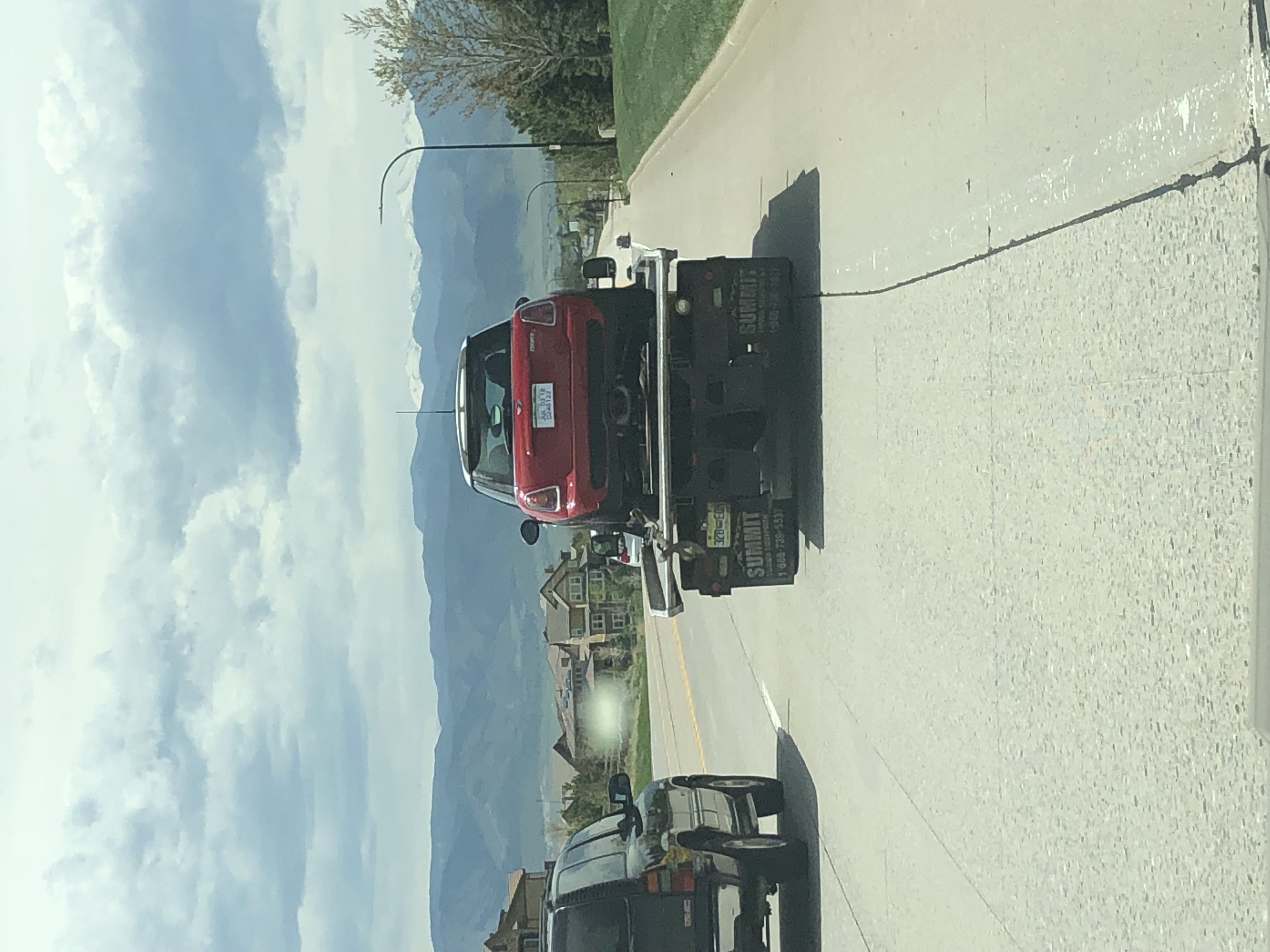

Sunday we had it towed to the dealership (Schomp Mini in Littleton, Colorado - they have been amazing).

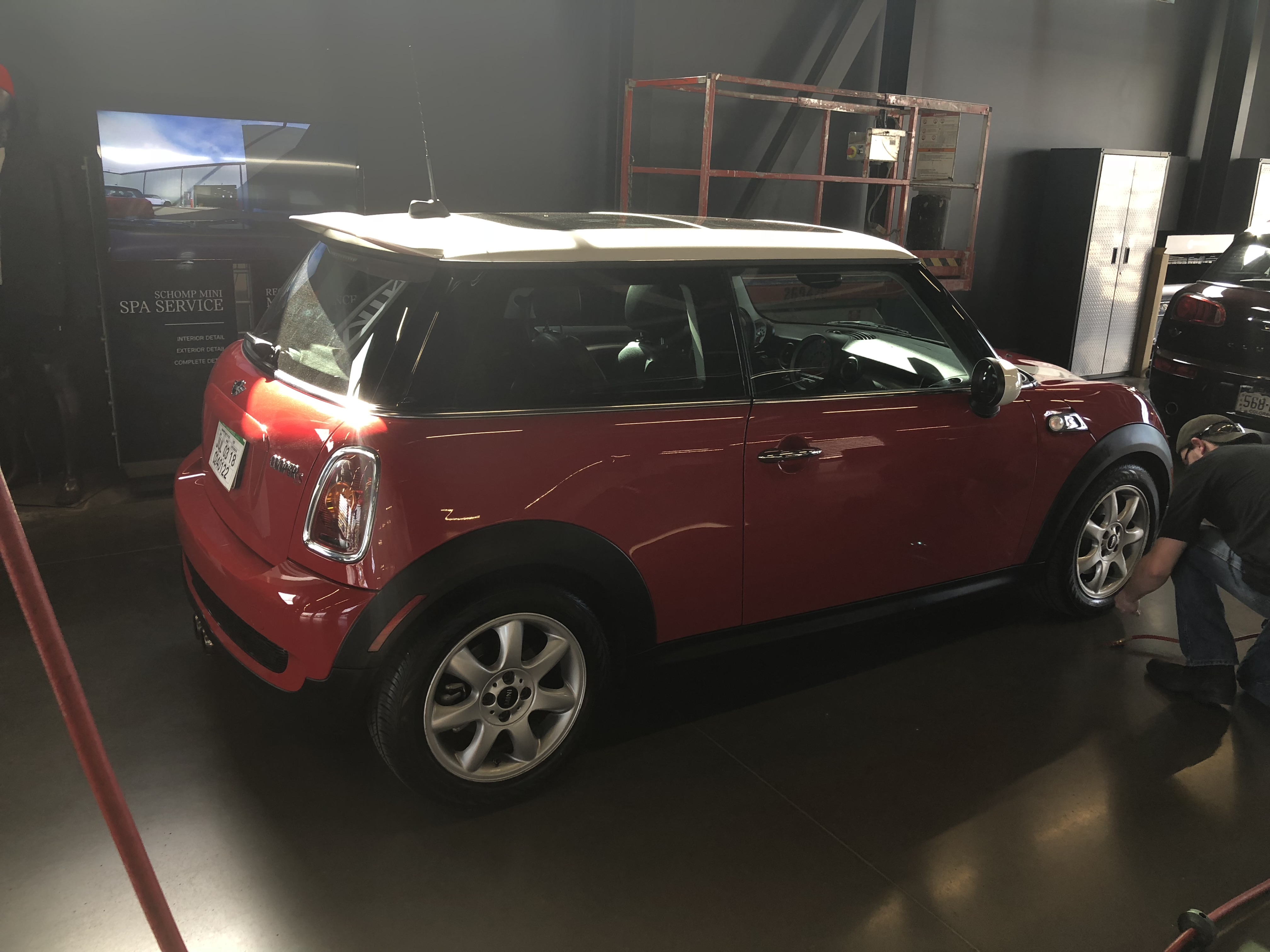

Monday morning we swung by at 9 and asked for the sales manager. Explained the situation, told him we hd only put 19 miles on it, etc. He walked us to service, got us set up with the service manager, and told us he would call later on Monday with three options, once they had diagnosed. Three options were:
1. Fix the car to our satisfaction, at their cost, and get the car back.
2. Find a comparable car that we were happy with, even if it were slightly more expensive/newer, and get us set up in that for the same price.
3. Refund all money and call it a day
They called and let me know that the clutch was shot. Basicaly what you all described - PO had probably never broken in the clutch properly, rode the pedal, etc, and the driving I had done just did it in. They also discovered that one foglight was out, and a tire pressure sensor was bad.
They are replacing all three items, at their cost. We are going with option 1 to get the car back.
