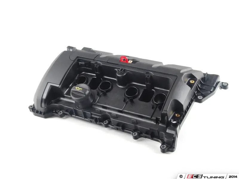

My cover came in. What do I do with the little cap? Something about a red pull tab??
edit: holy crap its a good thing I compared the covers because somehow I ordered one for an n14
Old Feb 11, 2019 | 12:28 PM
Posts: 36,758
Likes: 2,548
Post #40 Pull to inflate
https://www.northamericanmotoring.co...acement-2.html
Pull that out and replace it with the little dummy plug like below that comes in the baggy.
This is the N14 valve cover. ^^^
The N12/N16 Engine valve cover is here: 11127646554
https://www.ecstuning.com/Search/Sit...h/11127646554/
The N18 Engine Vlave cover is here: 11127646552
https://www.ecstuning.com/Search/Sit...h/11127646552/
