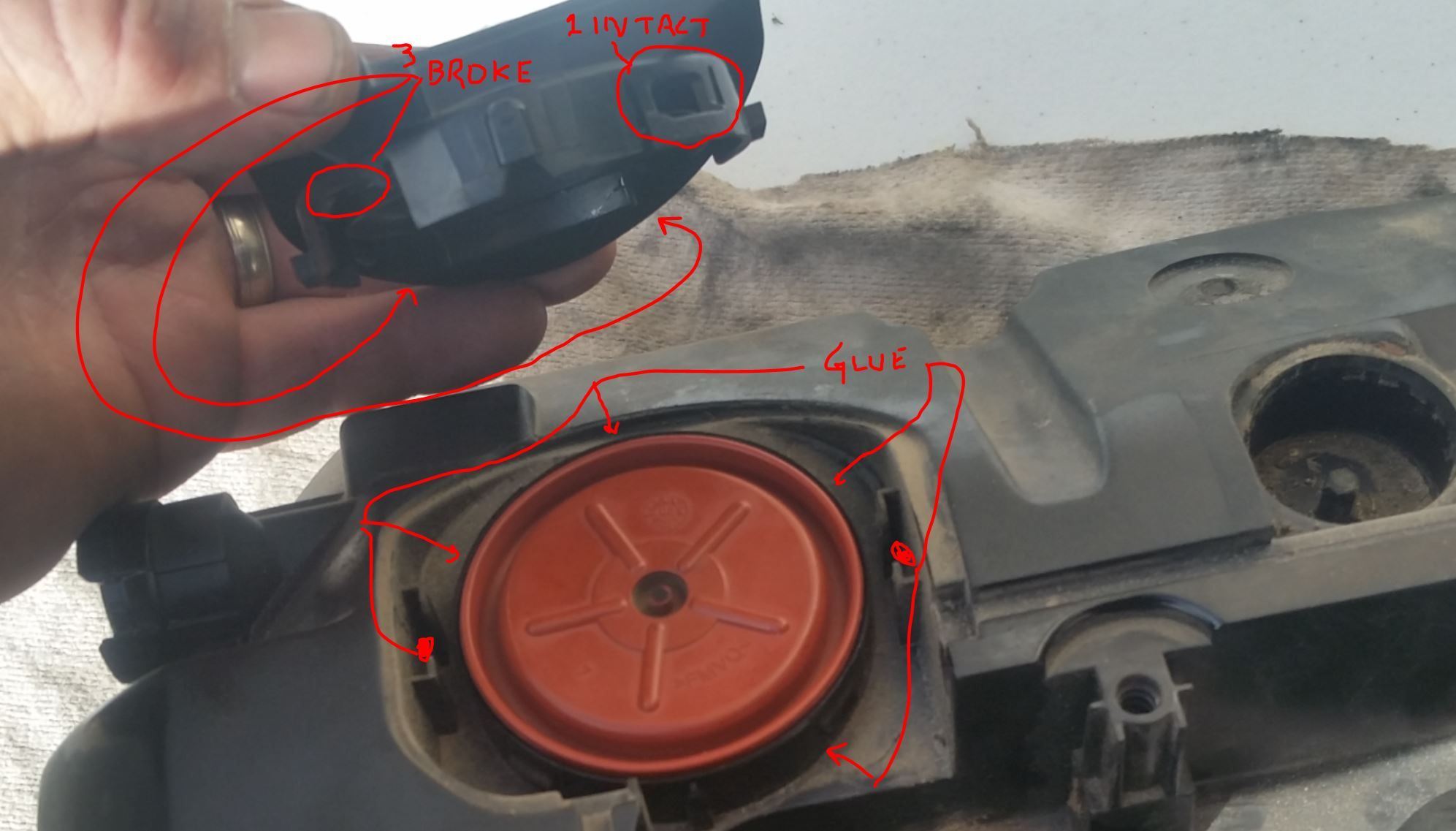

PVC Diaphragm Inspection: On the Justa VC, there is only one PVC outlet which goes to the CC breather hose on the passenger side of the cover. I don't think the Justa VC has all the various flapper valves like the turbo models. I had seen somewhere where the circular cap could be removed and the diaphragm valve under it inspected and even replaced. It was this diaphragm which I suspected could be the underlying issue to my rough idle and consumption. There are four tabs which retain this on the 09 Justa, only one can be seen. I was easily able to pry this single tab up but its impossible to access the others. I broke all three of the other tabs hidden under the cap. (see picture) Here's another word of the wise...DO NOT REMOVE THIS CAP UNLESS YOU PLAN TO REPLACE THE VC. It is ridiculous to believe you can save these tabs. You wont, you'll break them and cap will not securely clip back onto the VC and consequently will not retain the diaphragm properly. So now, you can imagine my dismay when I peered down into a perfectly intact PVC diaphragm. Did I replace the VC? Of course not, (that's like 20 hours of wood chopping...remember, this is the low cost Justa maintenance plan) No, I flushed the internals in a bucket of super hot dish shop and vinegar (video here of that process... (
)then glued the cap back in place with a quality two part catalytic epoxy. I was surprised at how much grease and oil came out of the VC during flushing. It definitely had oil trapped in the internals. Do I think this was the root cause to the Rough Idle or the Consumption? NO, maybe partly. Before cleaning I could easily blow through the entire chamber without any obstruction (diaphragm removed), and it was the same after. There was no noticeable change from before or after. Perhaps I helped, but honestly, this process of removing the cap and jacking around with the VC will only lead to most people damaging a cover. I was hoping to see a torn diaphragm, my diaphragm was in perfect condition. Pictures are attached of the diaphragm, the VC, Etc. For those of you like myself who find it irresistible to not rip the cap off the VC to inspect this mysterious PVC system... take this advise when you glue it back together... only install the glue low on the outer rim of the diaphragm flange, or on the cap in areas where no contact will occur to the rubber diaphragm. (see picture) You only have one shot at this. I glued mine after reinstalling the VC. I installed the glue, then gently set cap on the VC (once you have the glue in-place, and you put the cap on, don't remove it....you'll only drag glue up onto the diaphragm). I then made ball of rags with duct tape and sat that on top of the cap, and then closed the hood. This compressed the ball of rags and kept a fair amount of force pushing the cap down. (don't dent your hood, don't force it to close, use sense. Idiot disclaimer intact...lets continue) The next day, I tried to remove the cap...its stuck on their for life... I feel confident I did a fair job of securing it back in-place without damage.
