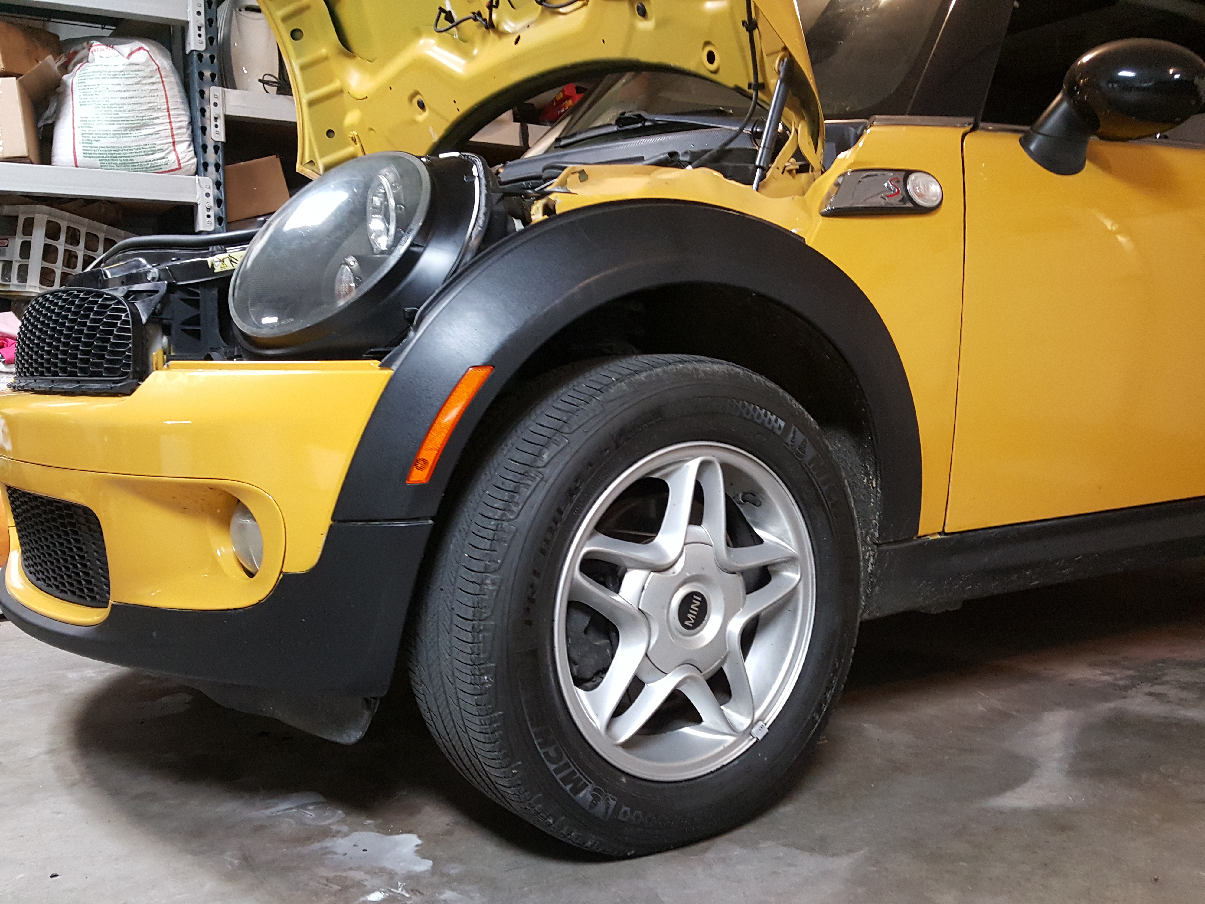

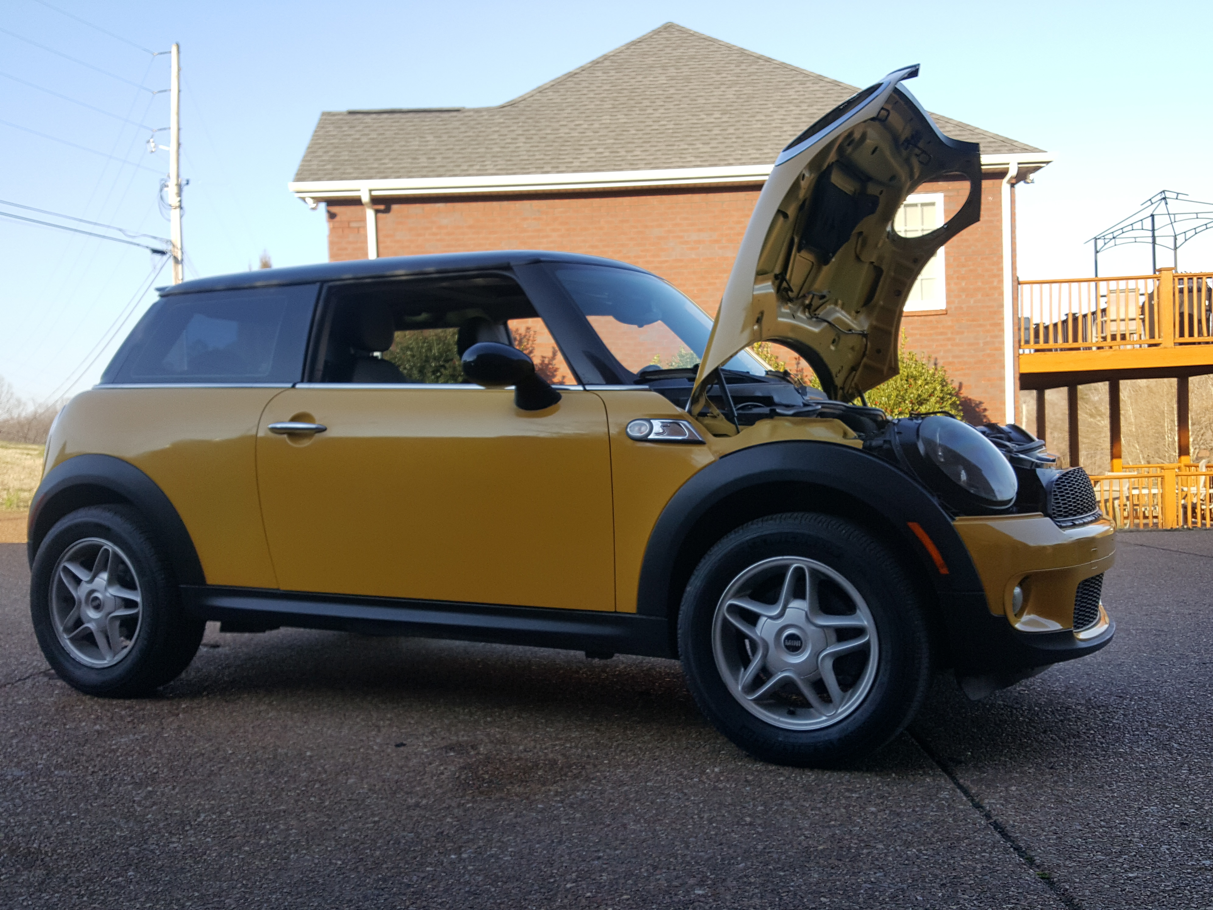

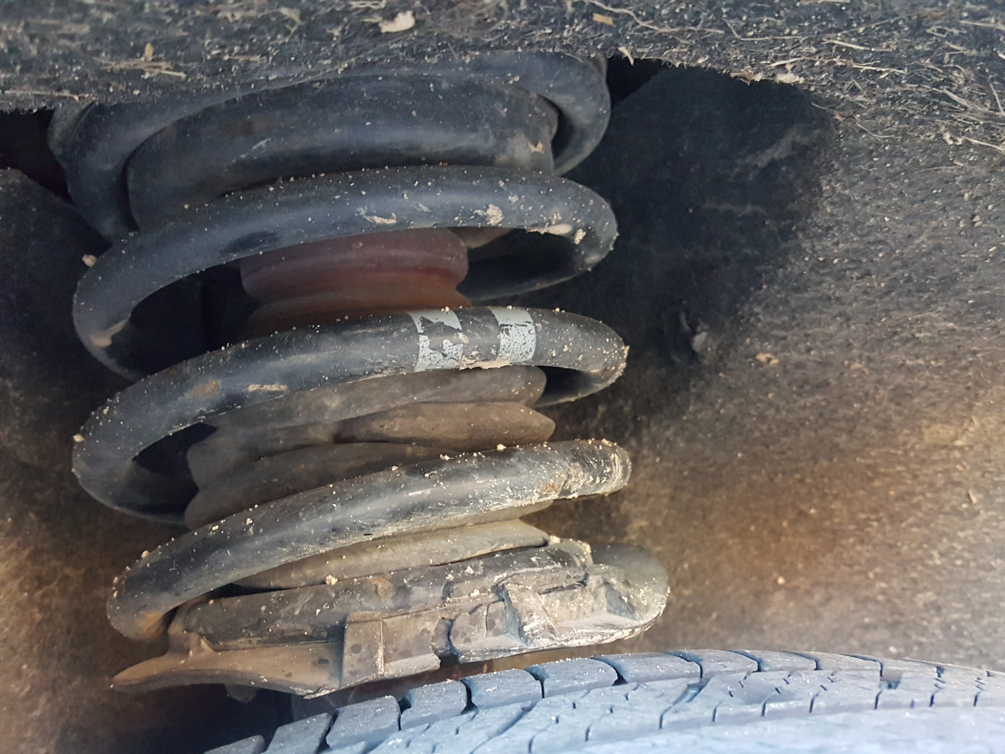

I snagged an R56 today that's stanced like a monster truck. Obviously the tires are oversized 215/60-15, but that doesn't explain the huge gap in the fender wells. Any ideas on what's going on? The springs looked stock.

At this point, the damn car looks like a tortoise!

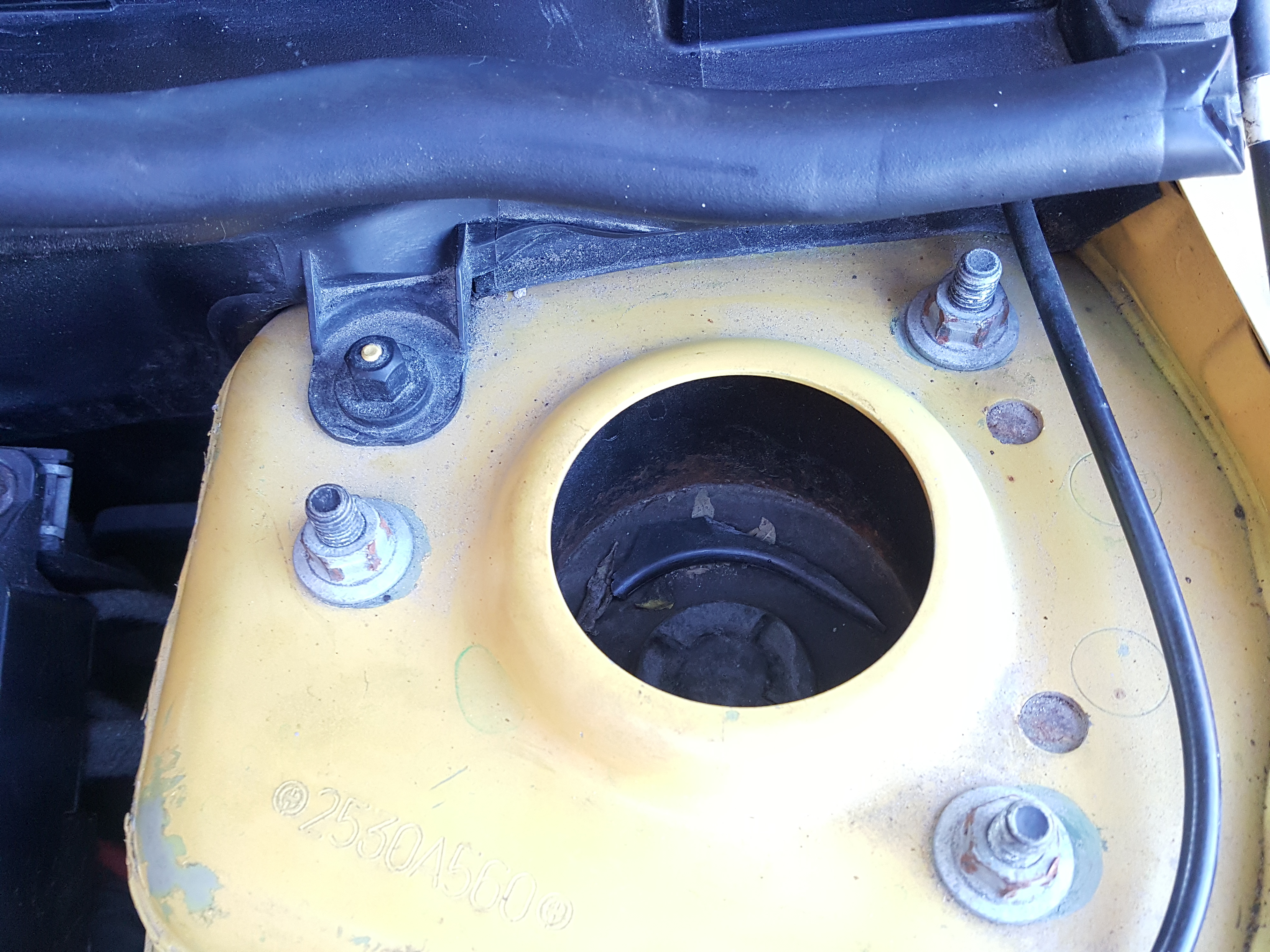

Maybe it's the angle of the picture, but pic #5 actually makes it look like there are spacers between the strut plates and the body of the car, which shouldn't be. How deep in that center hole is the top nut of the strut?
The strut plate in this pic is around 1.5" - 2" from the body. It is clearly different compared to my R53's.
Well there's your 2" of lift. The strut top plate should be against the body of the car. Interesting way to lift but I'm sure this is ****ing the suspension geometry in some way.
Looks like someone installed a coopercrap kit on it: http://www.crapindustries.com/coopercrap-home/r5556-2-lift-kit/index.html
I'd never heard of a lifted Mini Cooper until now. Looks to be a real PITA to remove.

Looks like you might be able to just put the car up on jack stands, let the wheels hang, unbolt the top of the struts to drop them a little, take the spacers off, then push the struts back up to where they should be.
No idea if those tires would fit under the fenders with the stock suspension though.
Maybe it's just the angle of the picture, but it looks like someone did the joey mod on your headlights and didn't put them back in the correct position. They're a little misaligned with the chrome ring.
Nah the whole hood's out of whack. Looks like a front end crash and some "close enough" body work. Mine's the same way.
You're right, I didn't notice the mismatch between the hood and the wheel arch/fender and up by the windshield.

The spacer kit would be very very easy to remove. Strut removal on a R56 is total cake to do.
