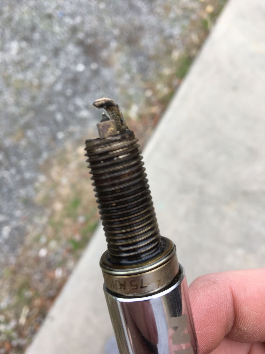

This is one of the plugs looks like oil is getting into it some how all the other plugs are dry
