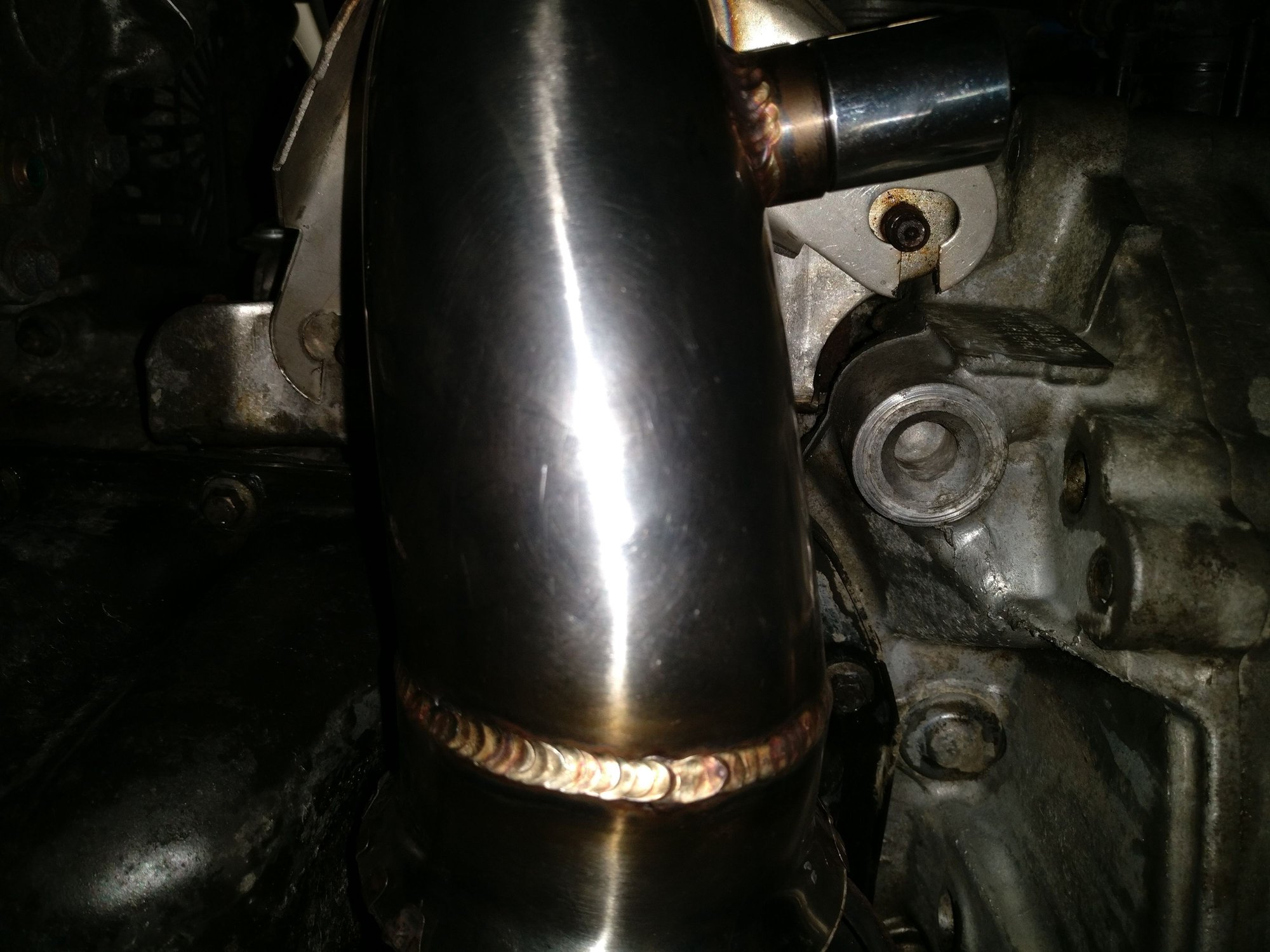

So.. I got it installed. Fitment was bad it needed to modified, also so far with o2 spacers I have no check engine lights. It sounds good a little louder than stock nothing to crazy I will get a sound clip as soon as its not 4 degrees out. I will update with pictures again later this weekend.

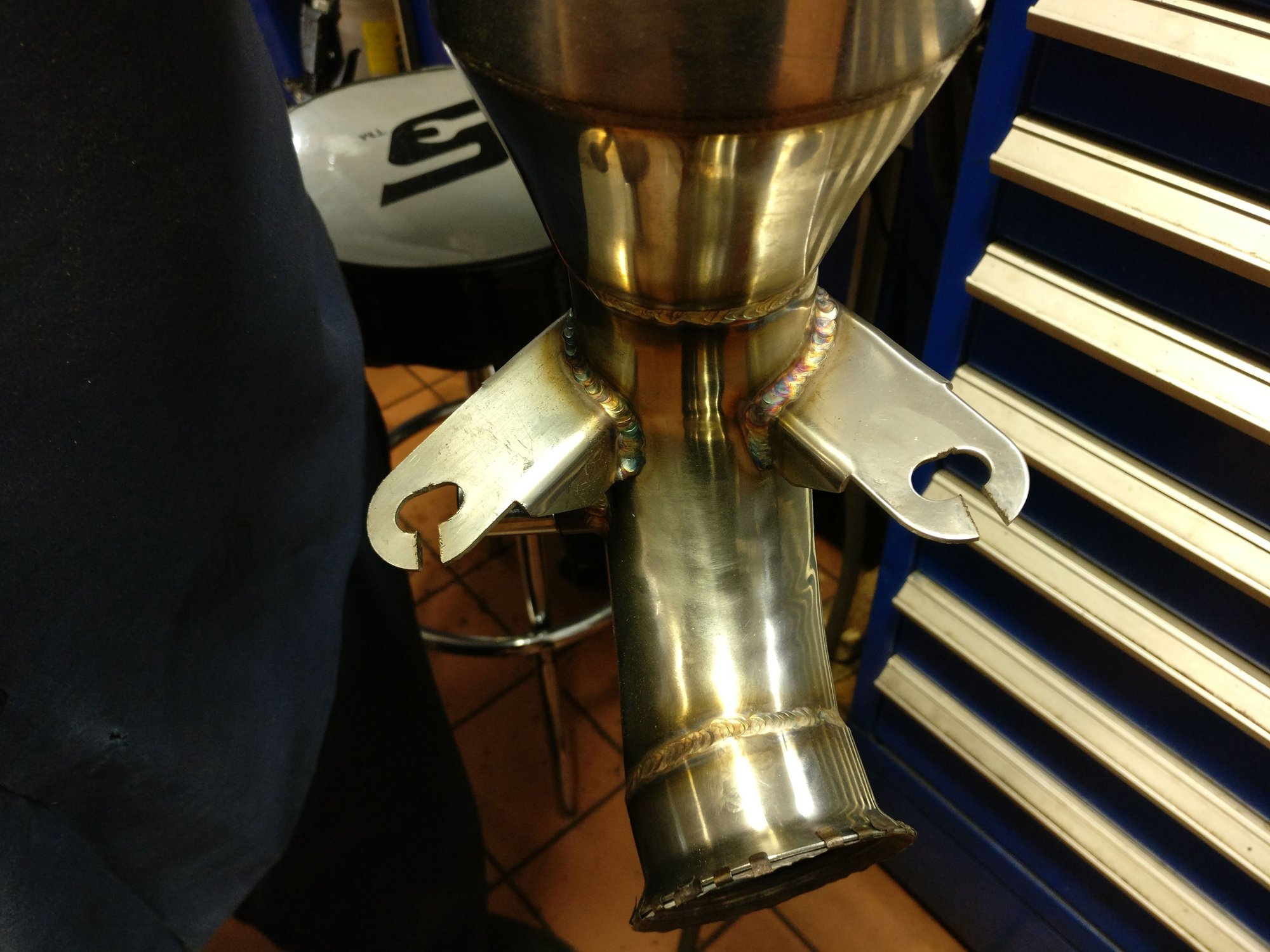

There are two tabs on the bottom of the DP which did not fit correctly. This may not be the case with all their DPs but for mine this was the case. But with problems comes problem solving. and for the 200$ i spend I perfectly fine with it.
You know the saying measure twice cut once? Well we ran out of time so we slotted it and rubber mallet!

No they had been welded slightly off so slotting and adding an addition washer was the simplest way for it to be done at the time.
Also to note its came with a complete POS gasket (only one) so make sure you have another factory one or try not to damage either of the two gaskets. The bottom gasket you need to be really careful with because of the tabs so be gentle with a screwdriver
