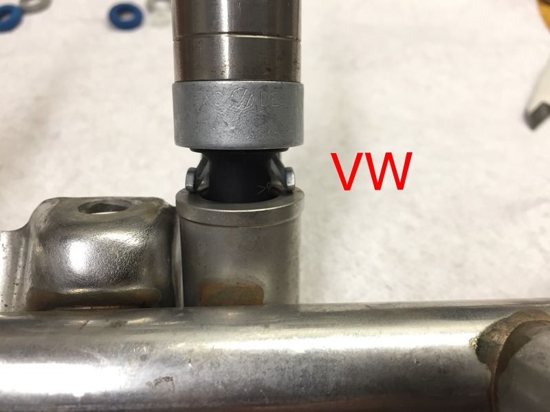

I got both the VW kit, 06J998907B (Made by Bosch) and the Bosch 2707010018 (MINI 13537573801 equivalent). The teflon seal, blue rubber o-ring and grey spacer rings are exactly the same parts.
What's obviously different is metal mounting spring. But, even though the two springs are of different design, they are the same size and function. Both have a spring height of exactly .715", both have an I.D. between .712" and .729" and the distance between the spring forks are both exactly .598". So close that I'd be comfortable using the VW spring on the MINI.
My old mounting springs were significantly compressed, so whatever part you use, I'd make sure to replace the springs and not just the seals.
