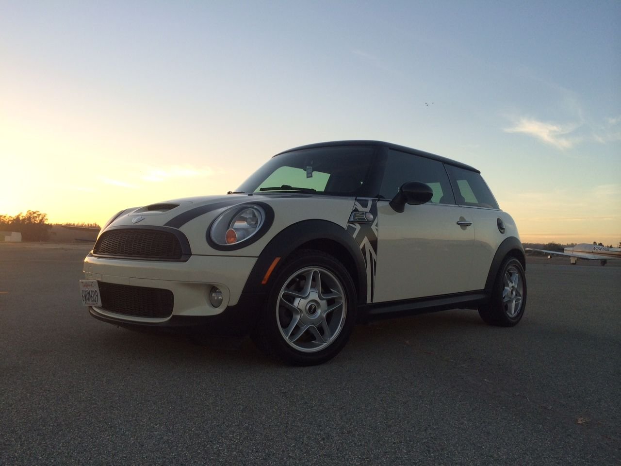

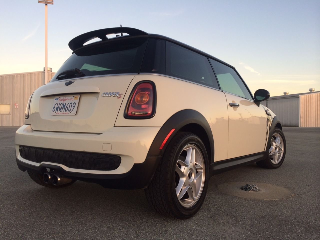

My very lovely 2007 MCS just lost compression in cylinder 3. It at least needs a head gasket, which the garage quotes at 20 hours and about $3500-4000 by their estimate assuming that there isn't a bigger problem as well. I know that the car didn't overheat, so I'm assuming that it's just a head gasket and it didn't blow a hole in a piston or something more serious.
I'm torn about spending $4000 on a car that's only worth about $7000. Does anybody know the salvage value of a very clean R56 MCS that was well cared for?

Nice looking MINI....sorry to hear about the problem. You might ask the shop to pull the head so you can make a more informed decision. You would then have some choices-

Nice looking '07. You really kept that clean.
