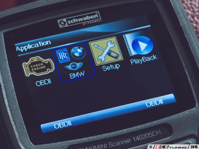

Some codes readers are hard to find codes, again and again. Actron units are know for this.
Get this for the future:
https://www.ecstuning.com/Search/SiteSearch/ES2975699/
