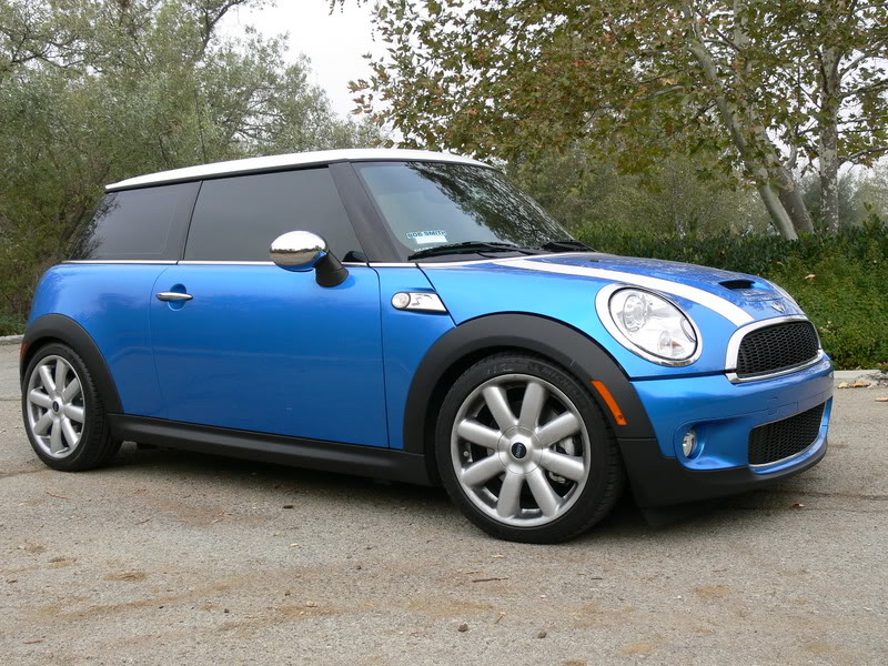

Background story..... we special ordered this Mini Cooper S at the end of 2007. We tend to keep cars for a prolonged period of time so we loaded it with options. It was over $35,000 plus tax and license. It is one of four cars we have and my wife's primary car. It currently has 35,505 miles on it. She tends to put under 5,000 miles on it a year. It is garage kept and all maintenance is up to date. I change the oil once a year using Mobil One 0w-40. The recalls have all been addressed. Over the last eight years the car has had zero issues.... until now.

Nice looking mini, glad it's back together. What type fuel do you use? Is Calf. fuel mix different than other states?
