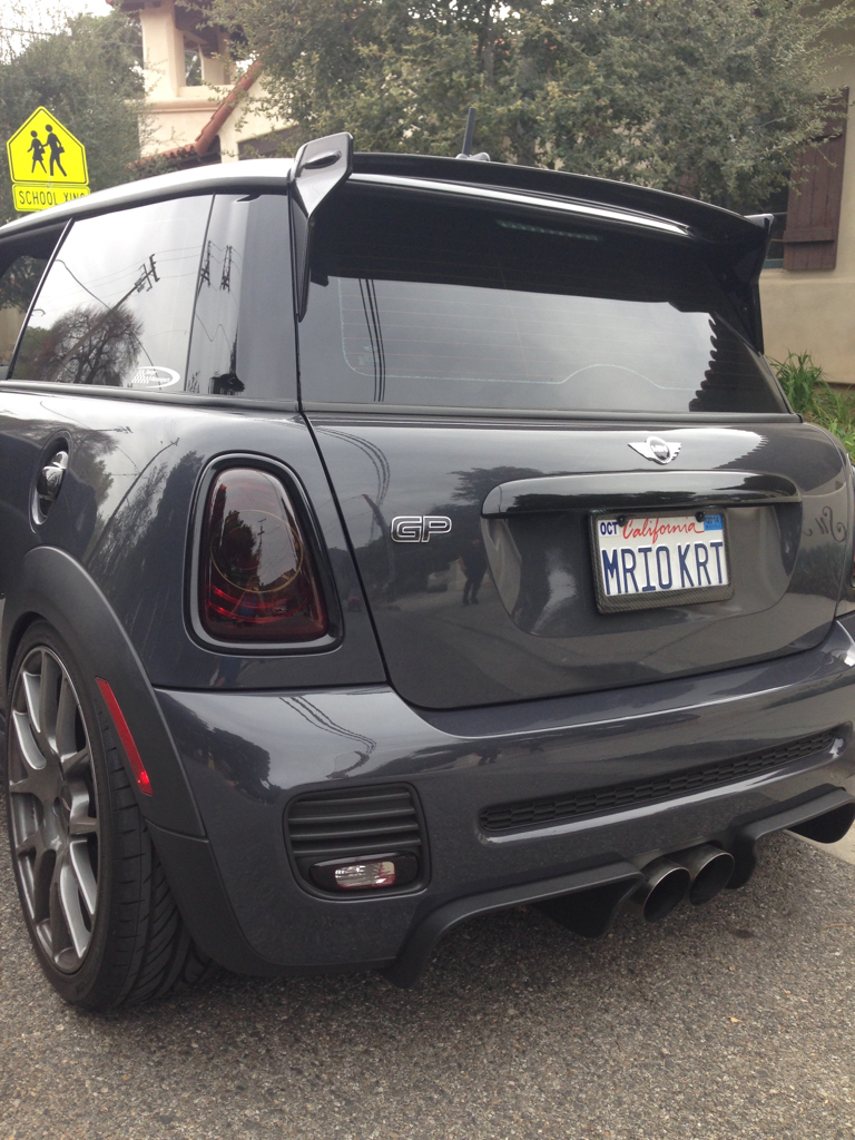

My GP with tinted lenses and LEF bright bulbs
mQubed Motorsport, Manic Tuning Dealer
