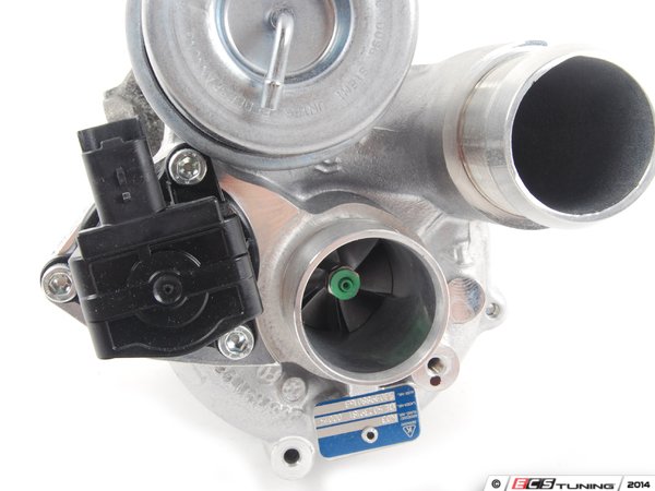

Newest stock DV design from MINI. 11658636606
http://www.ecstuning.com/Search/SiteSearch/11658636606/ES2768088/

There were two design revisions, then the newest one above. Form the old to the new looks like the similar VW/audi DV design based off what I can see.
You could see the yellow diaphragm between the plunger and the main housing, now the end plunger is different and the diaphragm is behind the plastic housing.
