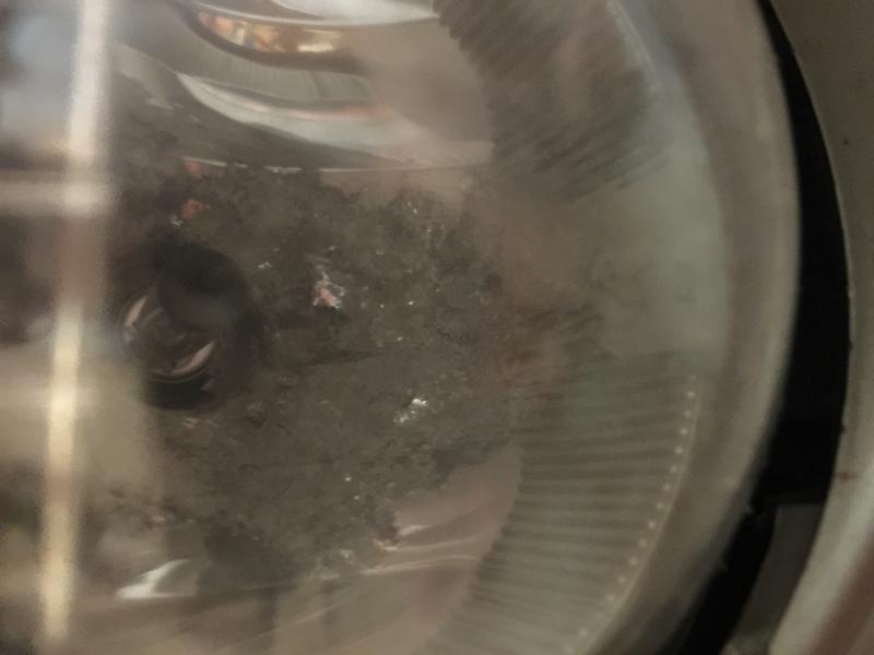

So the other day I was installing a skid plate and noticed that my fog lights both looked bad. so I called Mini and the said it would run me $190 to buy a brand new one... I didn't want to spend about 380 for two new fog lights.
Does anybody have any ideas? or do the lights come apart to where I can buy a damaged one?

Yea its corroded and the reflective material is pealing off or something , must have gotten water in there at some point. They are sealed units. 63172751295
You can either get new ones. Or just upgrade to LED DRLs.
http://www.ecstuning.com/Search/SiteSearch/63172751295/
DRL LED Fogs:
https://www.northamericanmotoring.co...installed.html
Here is the DRLs if anyone is looking for them. Part # 63122338554
http://www.ecstuning.com/Search/SiteSearch/63122338554/

They can't be disassembled; you have to replace the entire unit. I bought a pair of used lights off eBay several yrs ago for less than $100. This pair is on eBay right now http://www.ebay.com/itm/07-13-MINI-COOPER-S-CLUBMAN-R55-R56-R57-OEM-FRONT-FOG-LIGHT-SET-LEFT-RIGHT-/251939123266?hash=item3aa8bdf042&vxp=mtr. They can be replaced without removing the bumper but it's a little tricky. The right side is not too bad but the windshield washer bottle is in the way on the drivers side. Read post 10 in this thread https://www.northamericanmotoring.co...ml#post3410142.

They can't be disassembled; you have to replace the entire unit. I bought a pair of used lights off eBay several yrs ago for less than $100. This pair is on eBay right now 07 13 Mini Cooper s Clubman R55 R56 R57 Front Fog Light Set Left Right | eBay. They can be replaced without removing the bumper but it's a little tricky. The right side is not too bad but the windshield washer bottle is in the way on the drivers side.
Okay thanks! I will look into getting them used then finding a bright bulb for driving and fog light

Typically, you can open them up and see what you can do, but probably buying a new set is the best option. Have some options here. This tech article goes up to an R53, but can't see it being much more difficult to remove on yours. Might be able to use it as a reference for removal. Good luck!
