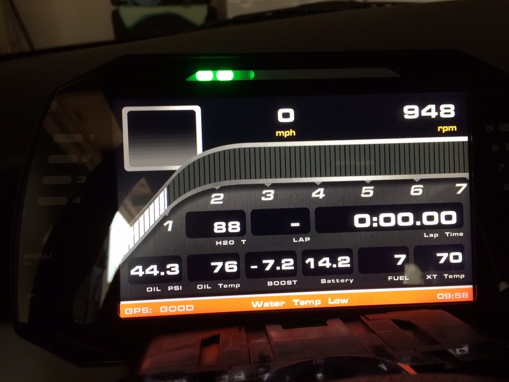

Best? Yeah...

^What's that? It is awesome!
James
James
AiM MXG.
Definitely not for everyone, but it will cost you at least close to $4k to run all the wires and sensors yourself. Easily more on top of $4k if you decide to have someone else do all the work for you.

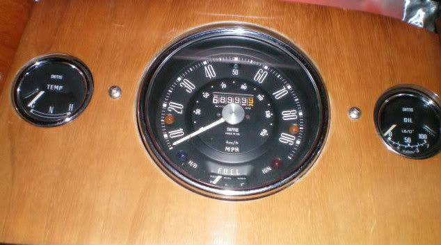

if adding dials ... look at what was on the Cooper and S of old
Oil pressure is a must add if you are going to add
(hmmmmmm does SCANG' report this??????)
and the other thing the classic had was water temp ......
if I was going to add another I'd go to AMPS .... one could argue VOLTS but either way you would want to see your electric's performance.
My current daily driver has water temp and oil temp and I find this redundant.
