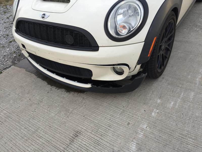

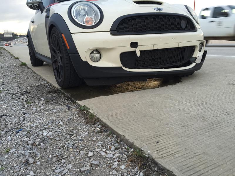

So, I was driving home from work on the interstate at 70+ mph and some unidentified flying object came hurling at me from under the car in front of me. As soon as I made impact, I immediately pulled to the shoulder as I knew there was damage. Came to a stop, and saw steam. I knew it was really bad at that point. I called insurance and tow truck. Upon inspection, it looks like said foreign object just pulled lower rad hose off, so not that bad really. The lower bumper, however, did not fair so well. Well, it got towed to the body shop for an insurance comp claim. They will see it Monday morning.
All that to lead me to this question:
Will I be able to possibly "upgrade" my stock bumper to an Aero bumper. I understand that I may have to pay a little more, and if so, how much more do you think it is or will be? My car is Pepper White and I know that places like ECS Tuning sell already painted Pepper White Aero kits. I would think that an already painted kit would be cheaper than an unpainted stock bumper and then paint job.
