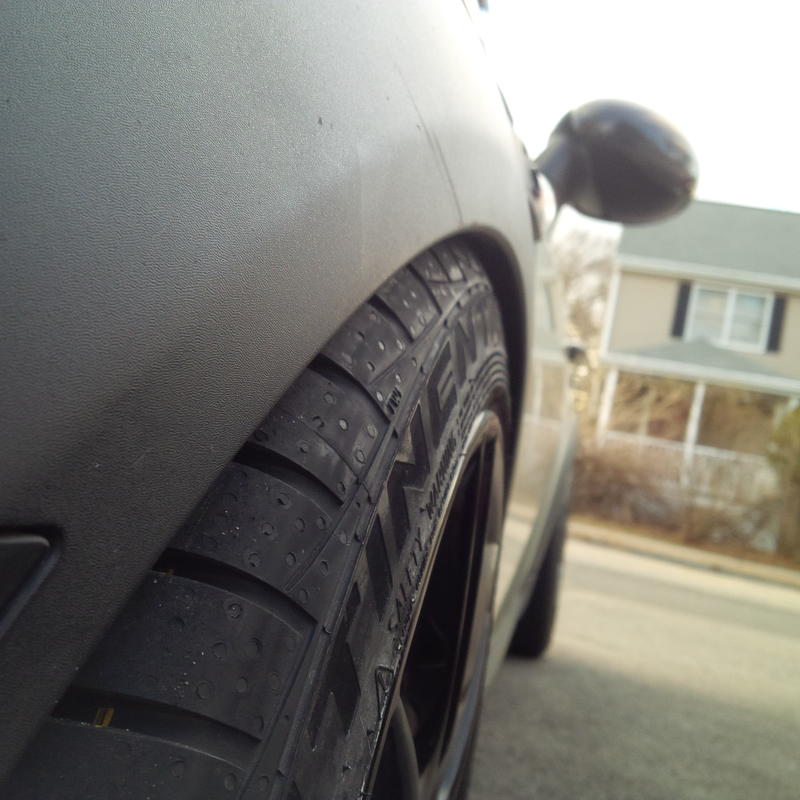

Old Apr 17, 2015 | 05:54 PM
DOtheDEW's Avatar
DOtheDEW
Posts: 361
From: Boston, MA
finally here are some pics if any one wanted to see
Attached Thumbnails Wheel Spacer Question-img_20150417_183340.jpg   Wheel Spacer Question-img_20150417_183313.jpg   Wheel Spacer Question-img_20150413_184319.jpg
Old Apr 17, 2015 | 07:29 PM
neonsteve's Avatar
neonsteve
Posts: 468
That looks sweet! You went with 15mm spacers? Do you have any rubbing issues?
Old Apr 18, 2015 | 03:26 AM
DOtheDEW's Avatar
DOtheDEW
Posts: 361
From: Boston, MA
I went with the 8mm spacers from ecs, my wheel offset is 38 so they stick out a bit, I have very minimal rubbing, only on big bumps
Old Apr 20, 2015 | 06:07 AM
Posts: 36,758
Likes: 2,548
Looks great, pretty flush.
