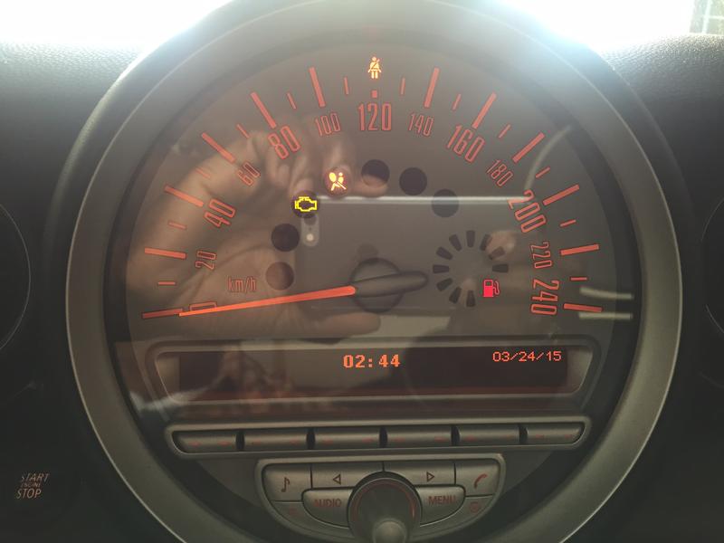

Hi Guys, I'm a noob to these forums, please direct me to appropriate sections if this is posted wrong. I have done a search and I can't find anyone, or any threads with the same problem as me.
I went to start my 07 MCS with (101,000 Kms) and upon ignition all the warning lights on the dash came on, my tachometer and speedometer are also disabled even when engine is revved or in motion. the display cycles through the mini on lift symbol, abs symbols ( photo attached).
I have also lost the keyless entry, trunk won't open. I dunno if it's relevant but I went on a quick road trip over the weekend and it was pretty rainy and wet. The car drove fine before and I've always kept up maintenance. Most recent service was an oil change
I have disconnected and reconnected battery, still nothing. The BMW service center nearest to me is 110kms away. If anyone on here has any idea what it could be, I'd appreciate some help trouble shooting before I have to drive to the stealership.
Attached Thumbnails 2007 MCS no Tach, Speedometer. All warning lights on!-image.jpg   2007 MCS no Tach, Speedometer. All warning lights on!-img_7865.jpg   2007 MCS no Tach, Speedometer. All warning lights on!-img_7861.jpg

Rainy and wet has to be more than a coincidence. Water must have gotten into whatever computer controls all those functions. I'm not sure what it is or where to look but hopefully someone else on here does. Good luck I really hope someone can help point you in the right direction.

my 2007 did this.
Mine was alternator. The computer starts turning off system in priority to save battery.

If your battery is in front of glove compartment is it wet?
Check your battery. It may be wet on that model. Clean terminals. Sounds like your carvis shutting down because you have no power.

Yes, car ran fine all weekend and on Monday as well. I actually drove it home from work around 2am on Tuesday. Went to start it at 1pm later that day and that's when all the issues came up. The Independent shop that services only German imports performed the last service/oil change, they claim it could be a fault with the AUX input that was a dealer upgrade and not a factory part but i think its BS. I'm the second owner and neither I nor previous owner have modified anything on the vehicle at all. I dont know if it matters but the last oil change was with 5w40 with ceratec additive in it which they said would help reduce engine wear. The engine runs good and i can actually drive it but nothing on the dash works except for radio and turn signals. Its currently parked though, cant risk making stuff worse.

Update: Went to check all your suggestions this morning before heading out of town. Car won't start, the battery seems to be dead, no electronics work. Whatever was wrong has drained all the power. I'm gonna leave It till I get back on Saturday.
