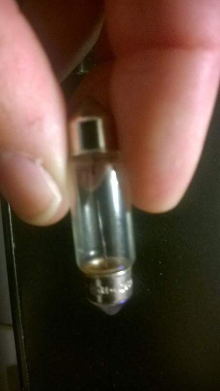

UPDATE:
Here is one of the bulbs she said she put in before problem started as far as I know or maybe light came on and then she changed out bulbs not 100% sure...
It is not LED of course. And data stamped on it are as follows:
OSRAM--
12V 05W--
37R--
E1--
0010--
n3i--
Do ya think a higher wattage replacement may solve the bulb warning lamp problem? I'm thinking these may be too low because they are not very bright-ish...
Thx Anthony

I have a bulb guide that someone made for the R56 and R55 that I'll attach when I can get to my computer. It'll have the bulb type and you should be able to find them at any local automotive store. Or you can order direct replacement LED lights from ECS Tuning that are CANBUS friendly so it won't cause bulb out warnings.
