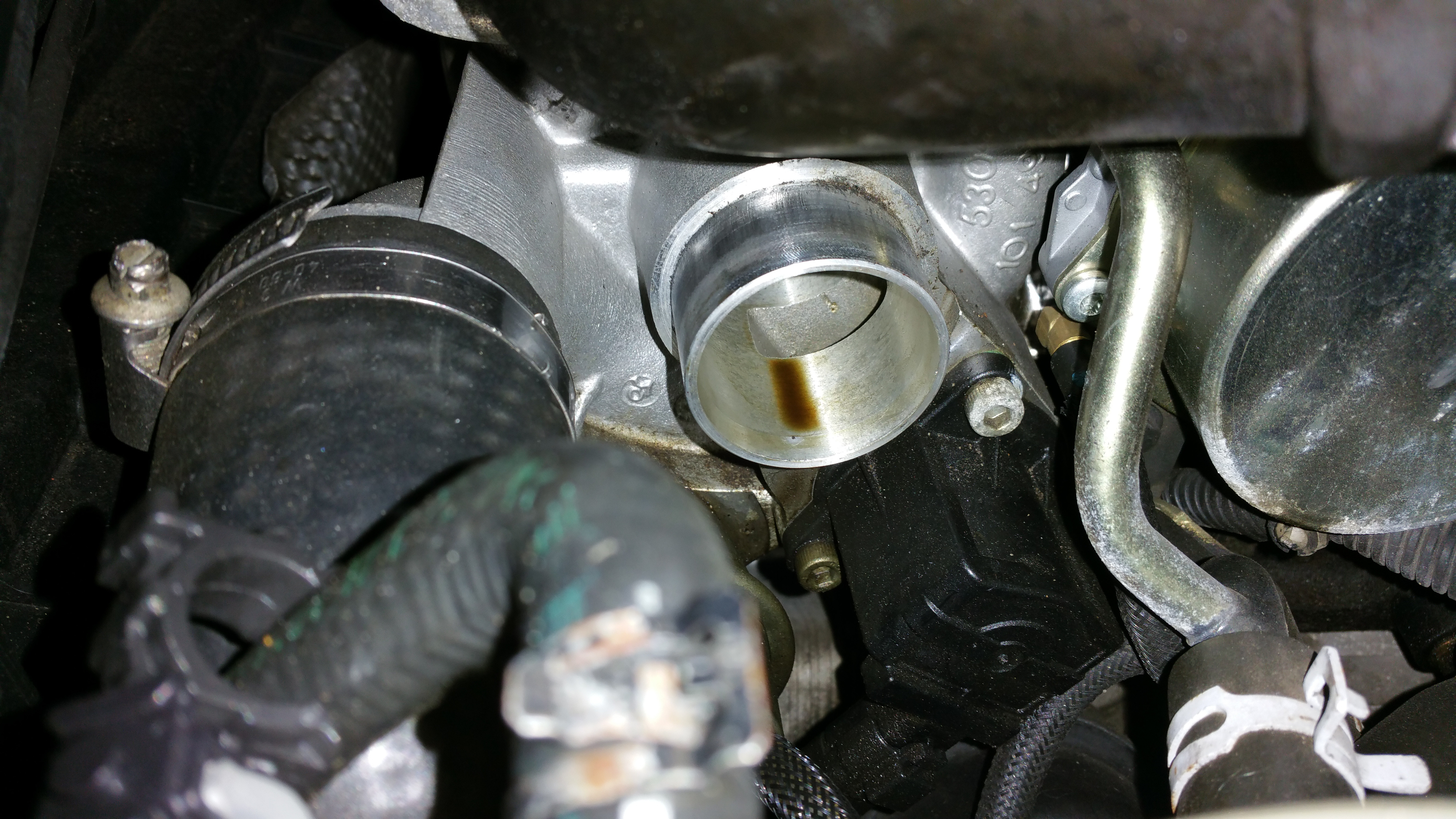

Took my my air intake from the air box to the turbo off. This is what I found.
Looks the PCV tube is dumping oil into the intake. The bearings on the turbo seem fine. Is there a way to make sure before I drop $300 to $400 on a new valve cover? Could I just disconnect the PCV valve tubes and let idle for 10 minutes? If it still blows blue smoke, then I would think it could be something else. Thanks for help on tracking this down!

Disconnect the PCV hose from the turbo air inlet hose. If your PCV tube is dry, the oil is coming thru the turbo seal because of high crankcase pressure. Disconnecting tubes and letting it idle will just cause more smoke --- crankcase pressure is relieved thru these tubes when activated by manifold pressure. PCV is short for Pressure Control Valve. High pressure (boosting) vents thru the turbo hose, while low manifold pressure (vacuum) vents directly to the intake manifold. All this is controlled by the valves internal to the rocker arm cover.
One more possibility --- the turbo oil drain hose might be plugged / damaged and not letting oil out of the turbo. Not likely, and a pain to get at, but possible.
