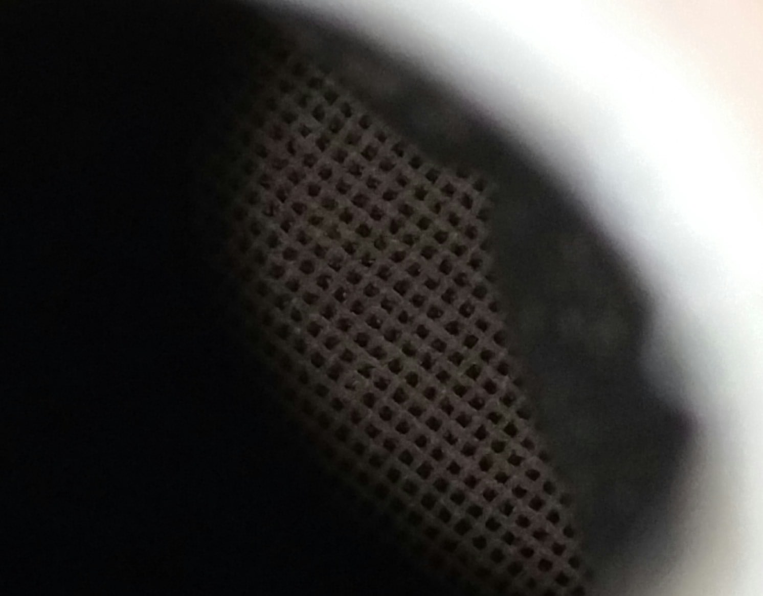

Should I worry about the second cat causing Back Pressure? Below is a picture of the inside of the 1st Cat. I guess it looks ok?

Check back pressure
The photo of your cats. Look pretty bad. I've done a few r56 where cat was so clogged the car wouldn't even start. If you can do a back pressure test on the exhaust.

Yea, my turbo did not fail...or at least not catastrophically. So it did not drop a ton of oil in the cat. Plus as stated above, I replaced the DP/Cat. Should I worry about the second cat causing Back Pressure? Below is a picture of the inside of the 1st Cat. I guess it looks ok?
Yes, a clogged second cat will cause back pressure. If your valves are leaking and you're still spitting out oil, I'd worry about the new dp(if it's got a cat) and ultimately the turbo.
