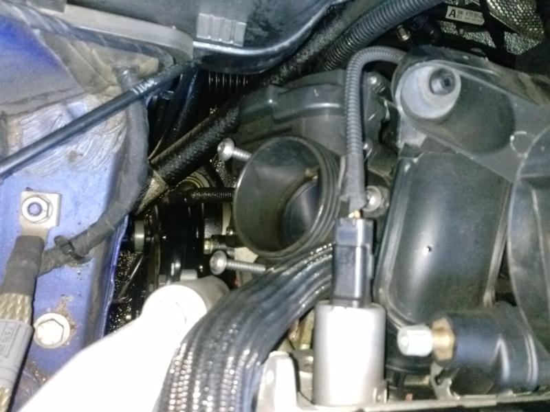

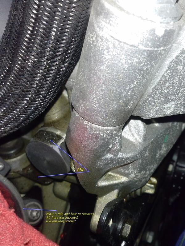

I have an oil leak around the Timing Belt Tensioner on a 2009 Mini Cooper Hardtop (R56). I can't tell if the tensioner is leaking or something near it, like a gasket. I couldn't find a diagram of what is around the tensioner.
I attached a few photos of what I can see. I took off an air hose and could see what looks like a tensioner. I was thinking of tightening it but a metal air flap is in the way and not sure how to take it off. Is it better just to take it to the Mini dealer and let them diagnose it to make sure it is the tensioner that is causing the leak? I would think they would check it for free and offer some discount to fix if that is the issue.

Seal ring on the tensioner is leaking, seen several do it, needs a new seal so the tension has to come out, change seal and refit.

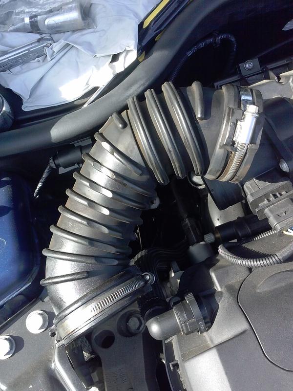

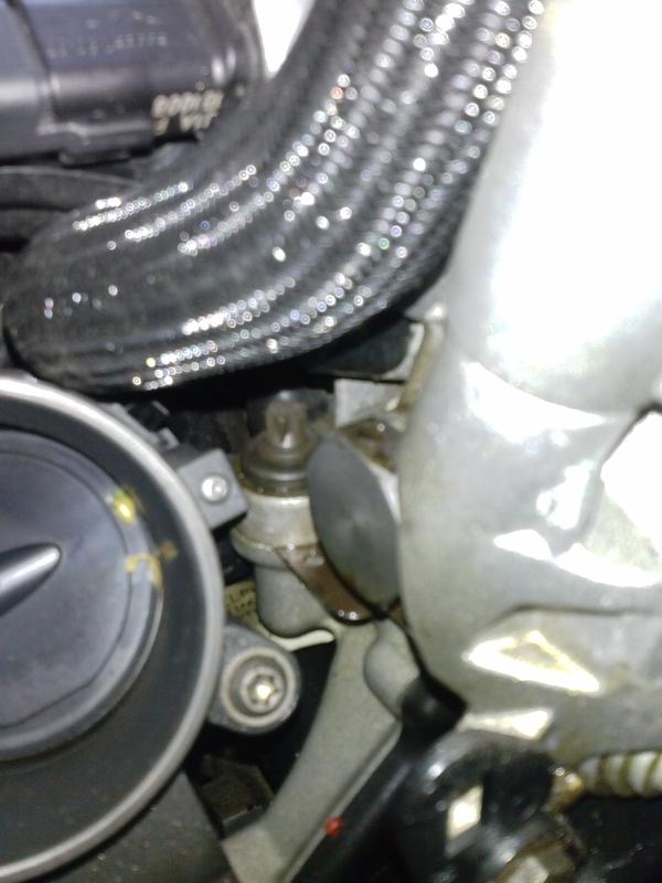

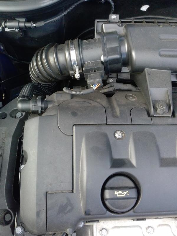

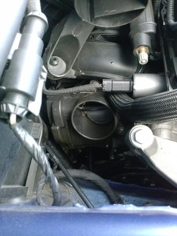

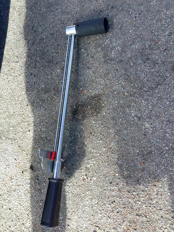

here are a few photos of the torq screws and removal. The one at the bottom of the air vent is the hardest to find, unless you know where it is. Its hidden from view when looking at the air vent, but its actually easy to remove, once you know where it is.
I first removed the rubber hose (just the top part), and moved it aside. Removed the metel vent (with 3 torq screws). I had full access to the Tensioner at that point.
The tensioner was loose. I could remove it with my hand. So I just put a socket on a torque wrench and tightened it up. The leak has now stopped.
The sound of the engine is good. I'll check it this winter to see if there is an issue. If so, I might buy the new tensioner and just replace the old one. Luckily for this model it was really easy to get to. It will take me about 30 minutes to remove and replace the tensioner. On turbo models, I think it is a little more difficult.
