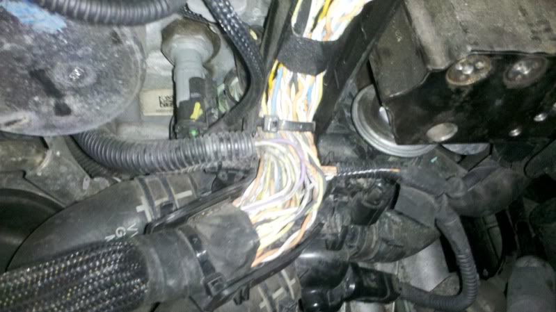

When you change out the thermostat housing, you have to watch that main wiring loom that sit right above it, some of the wires go to the coils. That one look in the wire shott with the platsic cap off shows it going to the coils. . There are also a bunch of cables tied into it. I hope its just something missed and unpluged. But you might have pinched on of those wires.

There is something disconnected at the electrical connection right above the thermostat housing. That's the only area that could have been touched under the repair. That would cause this. Also look back at that thread:
https://www.northamericanmotoring.co...hermostat.html
