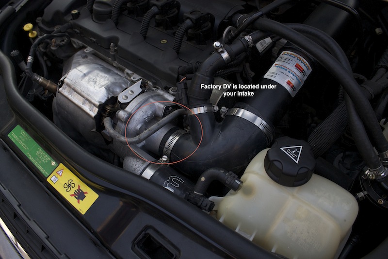

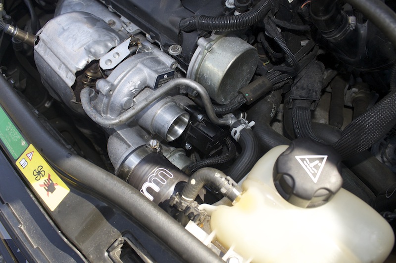

Installation:
Pop the hood of the MINI and locate the stock DV. It’s underneath the intake side of the turbo. Remove the intake hose and you should get a clear view of the valve. The tricky part is actually removing the 3 screws holding the valve in. Mine are 5mm Hex. (I have a Forge Motorsports BOV Adapter Plate that re-routes my factory DV to atmosphere.) The difficultly lies in getting to those 3 screws, specifically the bottom one, with that coolant overflow tank in the way. If you must remove that, it’s a 10mm socket. After fighting with the coolant tank and unplugging the solenoid, I finally get all the stock DV off the turbo housing and refer to the diaphragm for assembly. Basically, the DV+ replaces the OEM DV internals for a better design. The OEM DV is a diaphragm on a solenoid, which is really only intended to work efficiently with the stock boost. The DV+ replaces the diaphragm with a vacuum driven piston. The concept doesn’t actually come to life until the valve is fully assembled in the palm of your hand and you can see and feel how it’s going to work. Remember to oil the brass piston!!! Now, reassemble everything! Remembering to plug the solenoid back in!
