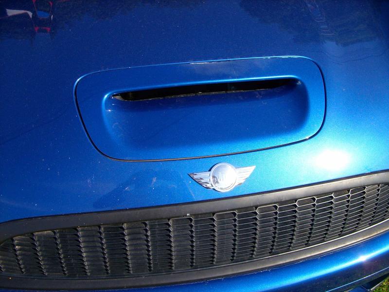

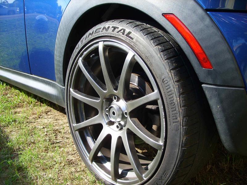

My first post...I am thinking of purchasing the R56 Mini Cooper S 2007 with 81,000 miles. First walk around check reveals dinged up rim and broken air scoop...see picture. During the test drive, I noticed the brake light stayed on...figured it might be just low on brake fluid.
I want to negotiate a decent price noting that I have about a year left on the tires and an upcoming timing chain replacement. Before I make an offer, what other things I should check (all)? It seems to me that the car might not have had TLC.
My intent is to modify for autocross as well as spirited daily ride

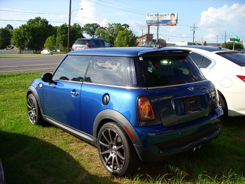

Thanks folks for responding...I appreciate the input. After studying the photos, I realize that the tires might not be runflat as well as the rim are eighteen inches ones. The tires are continental tires; however, I haven't seen SSR on the tire...will look some more. Forgot to mention earlier that there is a rattle in pax door inside handle when riding on rough surface.
I am thinking of offering $7,200 if the compression test pass...fair!

Edit: Oh, and I didn't see anyone mention it, but the hood scoop in your pics appears to be melted - a fairly common problem on these cars. Do a search for "melted hood scoop".

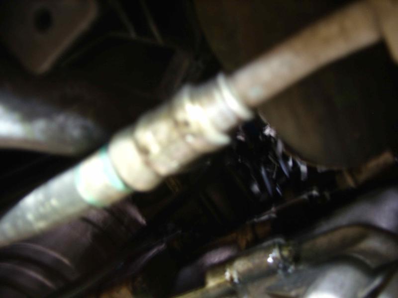

I noticed some oil leak but could not get a good shot of it (see pic) to tell if it just a valve cover gasket leak. I had also taken a video shot of the engine for the sound on start up...sadly it did not record even though indication claimed it was happening...camera battery could have been low. I might need to see whether the dealer will let me jack the car up and place it on stand. So, I have not made an offer yet.

If the car is at a dealer and has the brake light on it's almost certain that the fix is either expensive or difficult (or both). If it was cheap and easy the dealer would fix it themselves so as to not have it bringing down the value of the car.
At a minimum if you're determined to pursue this car spend a couple hundred bucks and get it looked over by a good independent mechanic who knows MINIs... They should be able to tell you the source of the leak, cause of the brake lights and probably some other stuff you haven't noticed yet. It'll be money well spent.

These are not factory wheels, Cooper S's didn't come with 18" wheels, 17" max. When you install 18" wheels you need to install a steering stop so the tires don't rub.
