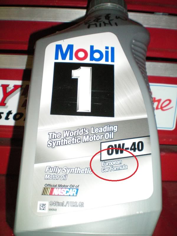

I used this in my MINIS from 2002 to 2013 ... going thru a GEN1 and a GEN2 car . . .
I let the dealer change the oil while under maintenance (at the factory/computer interval) and then started doing myself once every 6 months when my miles driven per month dropped off. About 8k a year now.
I can not remember ever needing to 'top off' even tho I checked the level regularly .. I did NOT 'burn' oil ..or lose oil . . . even at the Dragon
Neither car had an oil 'drip' when sold . . .
MINI OE filters all the time
