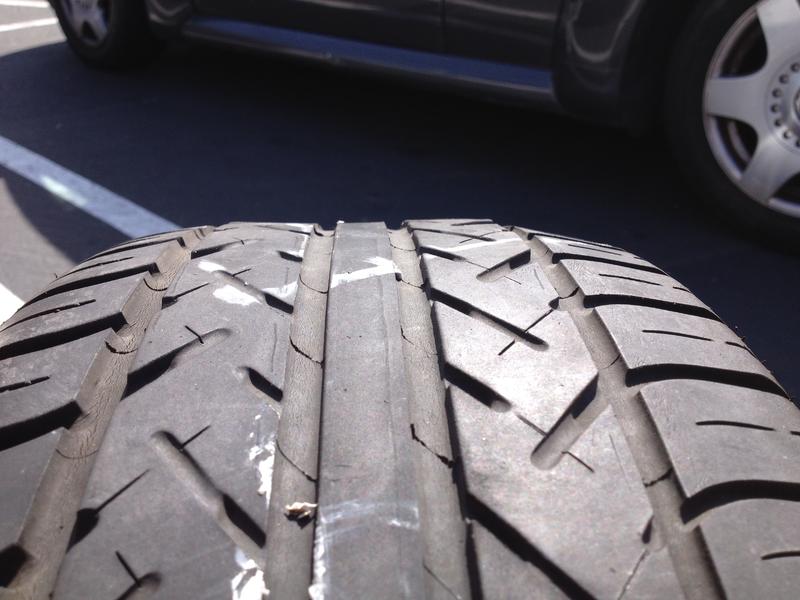

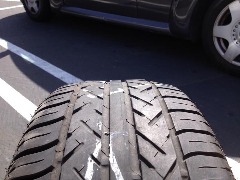

I purchased a set of four Michelin Pilot Super Sport tires today (205/45/ZR17) and something about the alignment isn't making any sense. The tire in the picture is cupped towards the center, the left rear Camber @1.7 while the right rear is @1.9. What are the factory spec for rear Camber and Toe in?
I'm told that the alignment on the two rear tires is in spec by non-dealer alignment shops, dealer wants too much for an alignment ($140). I do not want my brand new tires to end up cupped like the Pirelli RF. Is this what my Michelin Pilot Super Sport tires are going to look like in 5000 miles? I have 8k on the one pictured, I couldn't get any information from my dealer, they just kept moving around my direct questions.
Appreciate any feedback!
Attached Thumbnails Wheel Alignment, Camber Concerns!-img_1075.jpg   Wheel Alignment, Camber Concerns!-img_1071.jpg   Wheel Alignment, Camber Concerns!-img_1070.jpg

Cupping is not from alignment. It's a crappy shock issue.
Old May 11, 2014 | 06:18 AM
velvetcows's Avatar
velvetcows
Joined: Jul 2012
Posts: 174
Excessive tread wear in the center of the tire is an over inflation issue... is it not?
Old May 11, 2014 | 10:01 AM
Systemlord's Avatar
Systemlord
Joined: Mar 2013
Posts: 3,428
Likes: 37
From: Mission Viejo, CA
The highest I've run the rear runflats is 44 psi, there a hard still tire. Is this too high?
Originally Posted by [B
velvetcows][/B] Excessive tread wear in the center of the tire is an over inflation issue... is it not?
Hack - yes!
I run my street PSS's at 35 psi all around, and only pumped them up to 42 psi for autoX runs once (before going with faster dedicated autoX wheels+tires).
Looking at your pictures, there is nothing significantly wrong with the tire wear. Your tires were almost at the wear bars and needed to be replaced regardless, so whatever issues you had did not effect their usable lifespan. Crank the pressures down closer to spec, and your car will handle better, ride better, and the tires will last longer (excessive tire pressure marginally bulges out the center of the tires, accelerating center wear).
Also, your camber is near stock, nothing to worry about.
