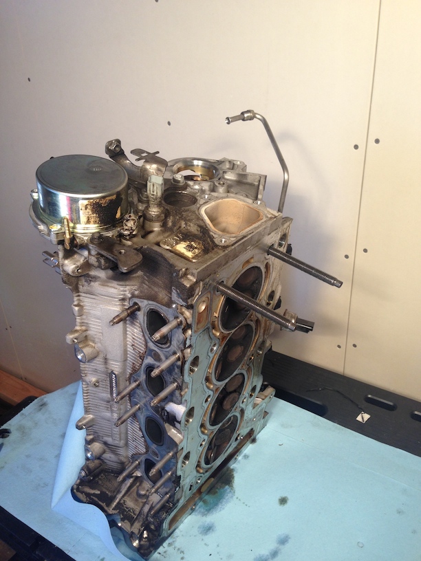

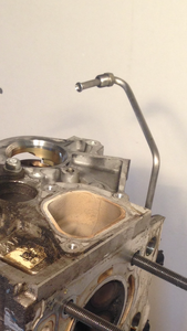

Some of you may have read the thread where my friend's R56 needs the head pulled. I'm 95% of the way there, but have run into a couple snags.
How do I remove this sensor (CPS I believe)? I've removed the bolt, but it just twists a few degrees and I can't seem to pull it out. I need it out to gain access to the torx headbolt next to it.

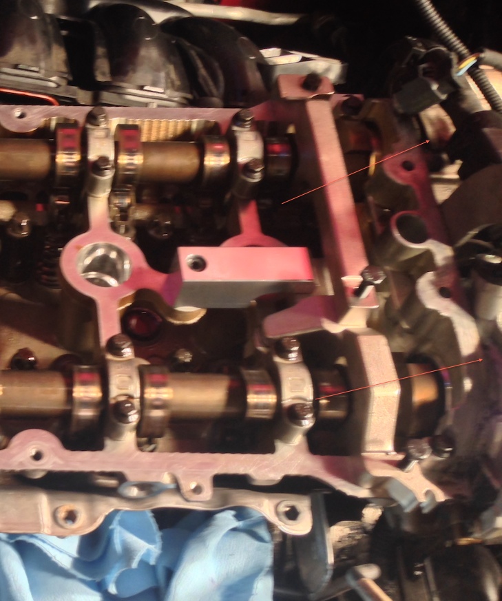

Secondly, do I need to remove the units attached to the end of the cams shown by red arrows in the picture below? I assume it's part of the VANOS system, but didn't see any instructions to remove it in the VANOS removal section of the Bentley manual. That said, I feel like I probably need to remove it to take the head to a machine shop. If so, any idea where in the Bentley manual to find the procedure?

Some of you may have read the thread where my friend's R56 needs the head pulled. I'm 95% of the way there, but have run into a couple snags. Just finished putting mine back together. As I remember ---
How do I remove this sensor (CPS I believe)? I've removed the bolt, but it just twists a few degrees and I can't seem to pull it out. I need it out to gain access to the torx headbolt next to it. There's an o-ring to keep oil from leaking. Try pulling it straight out.
Secondly, do I need to remove the units attached to the end of the cams shown by red arrows in the picture below? I assume it's part of the VANOS system, but didn't see any instructions to remove it in the VANOS removal section of the Bentley manual. That said, I feel like I probably need to remove it to take the head to a machine shop. If so, any idea where in the Bentley manual to find the procedure? These units are pretty straight forward for removal / installation. I personally wouldn't trust a machine shop with a fully assembled head. I stripped mine down completely (except valves and springs) before sending it out. Also had to get another special tool to re-install the DI system. Between the Bentley manual, the web site "RealOEM.com", and "mechanical know-how", this chore can be done by a novice with little Mini experience.

The DI system should be re-installed before any other assembly work is done. A dealer has the tools and needs the head and DI injectors to do the work. Talk to the SA BEFORE starting the re-assembly, unless you have the specified tools. Best of luck ---
Thank you for the reply.
What is the DI system? I didn't even see anything in the Bentley regarding having to remove the injectors or fuel rail. I understand they are high pressure injectors, which I haven't dealt with before. Can you give me a little more info on what I need to do regarding this or what to search?
One other thing... after removing the VANOS gears I allowed the timing chain to settle in the cavity. I've then read somewhere on here to "not drop the chain". Is this an issue? I just assumed once I pull the chain back up it will hook itself back onto the crankshaft sprockets, no?

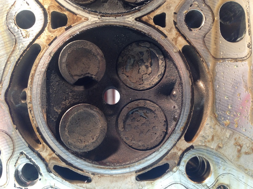

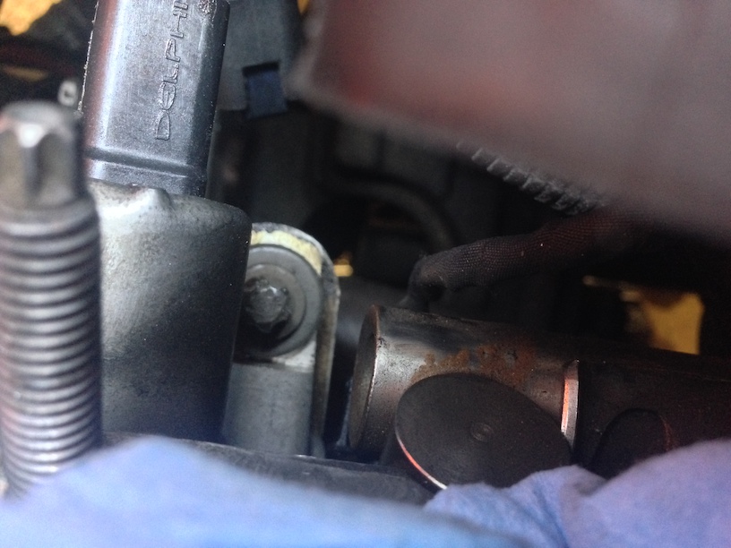

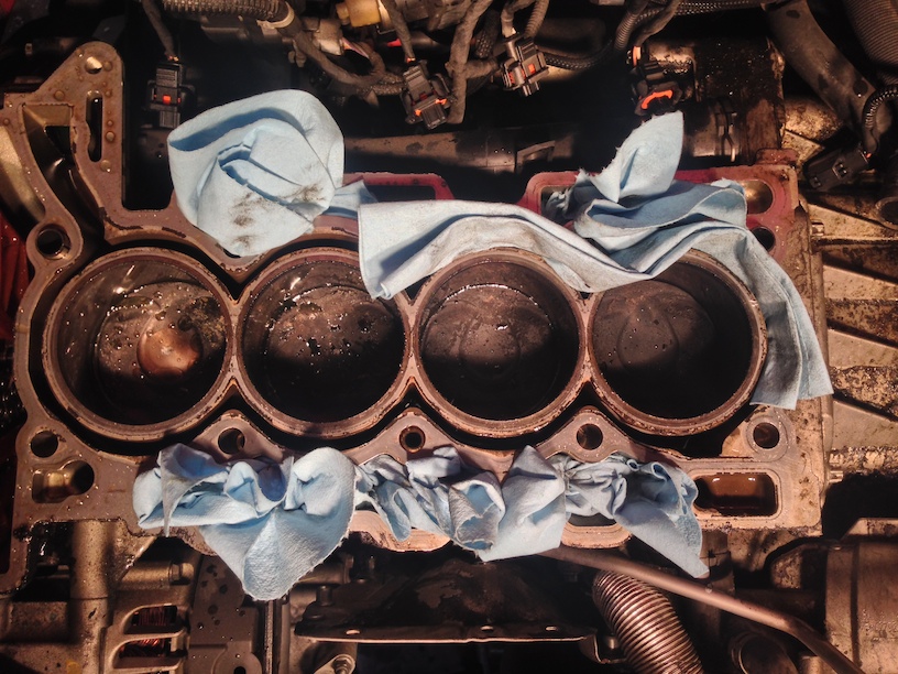

Some pictures:
Are the coolant passages supposed to be this color?

In all it's glory:
Carbon coated pistons (haven't checked the cylinder walls yet), some coolant leaked onto them:
And finally, the source of 0 compression:

Why do Mini's always have a piece of the valve broken in the same spots nearest to the plug?
If this is truly the case it would likely because the cylinder gas flow on every mini is going to be nearly identical, so if the electrode of the spark plug is the cause, and assuming it breaks during ignition, it will probably travel to a similar place each time.

Interior of the head should be bright metal. Your head cooling passages look like they were exposed to very hard tap water - for a long time. There is evidence of rust in the block cooling passage as well. Remove the water in the bores ASAP! I expect the head will need to be pickled in some mild acid to remove what appears to be calcium stain.

Don't worry, water is removed. It's not my car, I'll have to ask my friend if he was using regular water instead of distilled...
