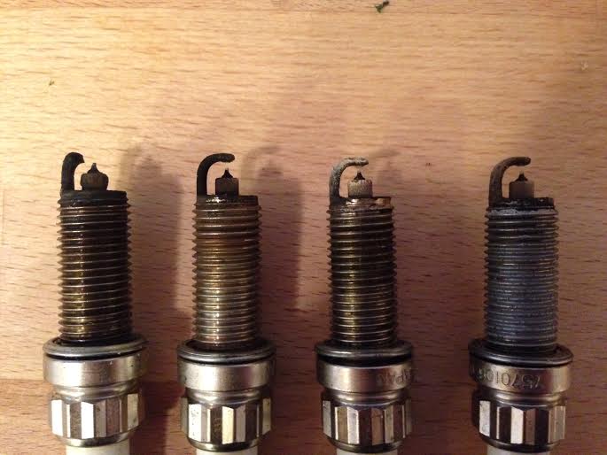

Have a picture of the plug?
Could have been pre-ignition going based off that.

Here is a picture of my spark plugs.

Could it be the piston skirt?

Damn.....pre-ignition will do that to plugs.
What cylinder did that plug come out of?

Or detonation, or mechanical damage due to foreign debris.
Which ever cylinder that came out of, I'd get that piston head checked, because that missing piece ended up somewhere......
And you say the car still runs rough correct?

It came out of 1.

I'm with NewCooperFanatic. The plug that is broken. That chunk went somewhere and that is the cylinder. You very probably have a piston that is damaged or cracked with other possible damage. Metal doesn't just dissapear and it's all fine. You may have a huge issue on your hands. I've seen smaller metal items cause same issues.
