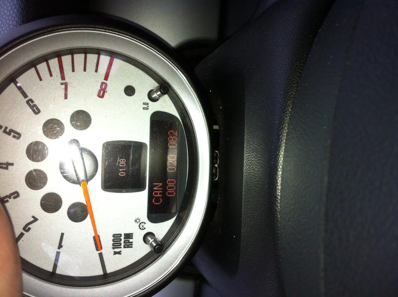

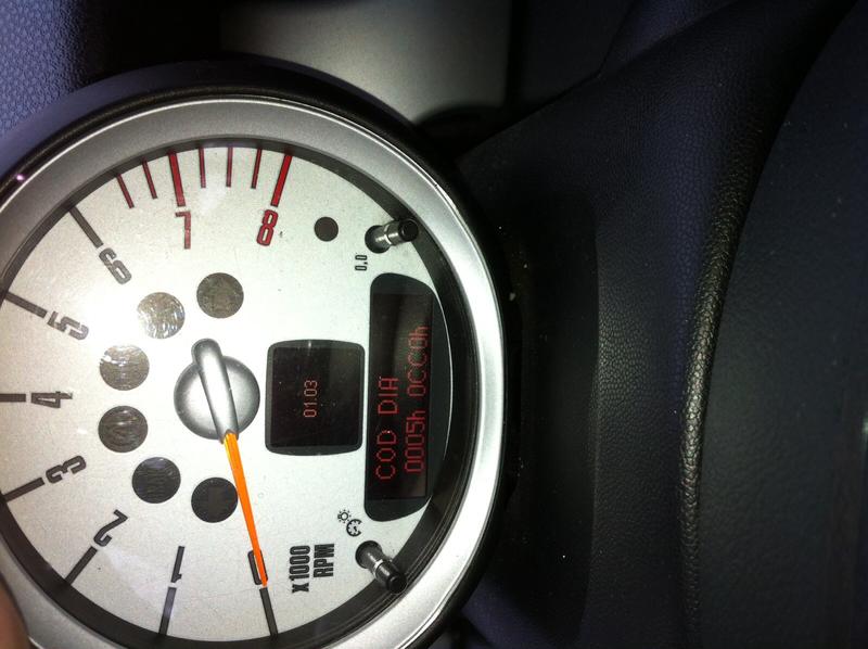

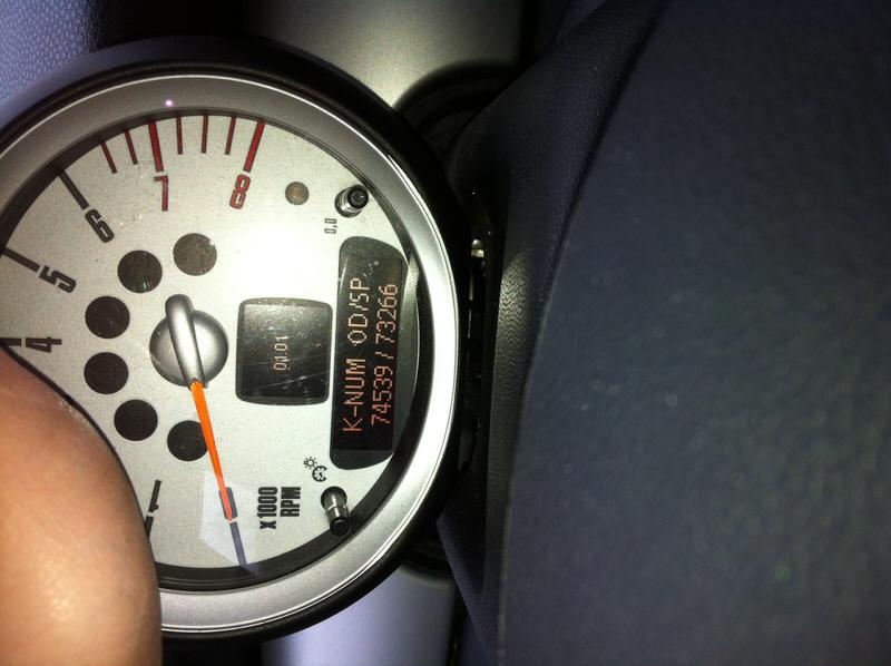

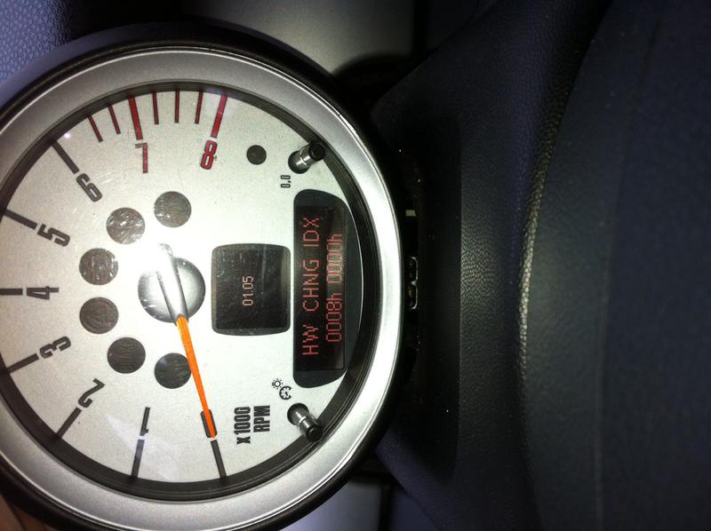

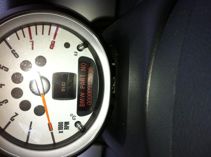

I came on this site in a thread about the timing chain job in general and asked about this. Someone said check your battery which I over looked as it seemed too simple. So I tossed my battery charger on it and I charged it up. Tried to start it again and nothing a few more times even when I turned the charger to jump start mode. Now purely out of frustration I held the button on the side of the turn signal lever and the two on the telling why I simultaneously said I f-n hate you to my mini. Well my mini responded with information that means nothing to me except that I should take pictures of what it was showing me.

You entered Service Mode and it is showing the related information. I think all that info is limited to the KOMBI (i.e. the instrument panel). Not necessarily related to the problems you are having. You can access the same information by holding the 0.0 button pressed on a fully-functioning car.
