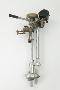

OK, this is hijacking this thread somewhat, but I think you guys would have enjoyed the owners booklet (manual is too grand a word for it) that came with the British Seagull outboard motor. This was a design (see below) that continued with very little change from the 1930s up to the 1990s and had bronze bearings. The booklet's advice on running(breaking)-in was "for the first ten hours of use, under no circumstances run the engine below three-quarter throttle and preferably use full throttle". Apparently this was to avoid glazing the bearings.
You don't get that instruction with car engines, more's the pity.....
